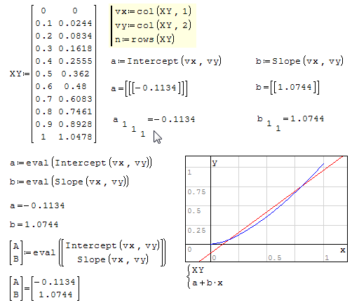

Can't explain to myself double/triple nesting [6179 Win 7].

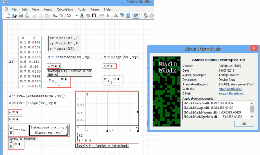

I get these errors when I run the file:

Thanks Jean, but I get the same error.
Is your Smath studio 32-bit?
My Smath Studio 64-bit, does not recognize the
functions of Interception and slope.
Carlos

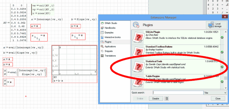

Hello!
Jean's example also works in my laptop (Win 10, 64 bit) with latest SS 6588 dated 14/01/2018.
The Functions are in Statistical Tools Plugin.
#10 Posted: 1/16/2018 5:36:02 AM
Carlos, do you have statistical tools plug-in installed and enabled?
