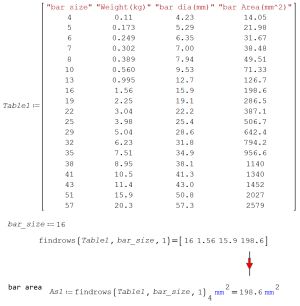

I would like to have a function like lookup (vlookup, hlookup) in smath.
thank you.
thank you.
João Felipe Seráfico Melo 3/6/2023 10:09:00 AM
#2 Posted: 3/6/2023 5:45:04 AM
findrows function within Special Functions plugin is what you're looking for, soomoon
#3 Posted: 3/6/2023 8:36:22 AM
WroteI would like to have a function like lookup (vlookup, hlookup) in smath.
Find Index Key Code is lot more powerful.
Assume your Customer wants more information from his bar diameter
you can give all pertaining informations ...
Add price column, material, delivery ... etc.
bar size Findndex KeyCode.sm (10.33 KiB) downloaded 1222 time(s).

#5 Posted: 3/6/2023 10:05:04 AM
Jean, your example shows EXACTLY what findrows does.
#6 Posted: 3/6/2023 5:23:05 PM
WroteJean, your example shows EXACTLY what findrows does
Yes for that simple application.
FindIdx(V,x,col) gives me more for advanced Engineering works
Thanks for the observation.
