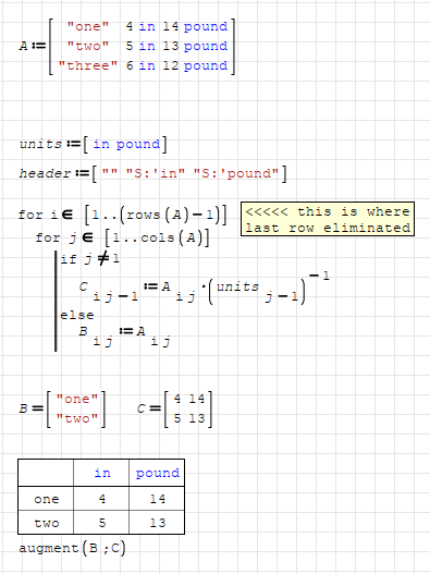

Well you can't show it with conventional ways if it contains string column.
I am not sure if it is possible when a string column is absent if it has mixed units.
However, you can use a table region to show your new matrix.
Not an ideal solution, but it is what we can have.

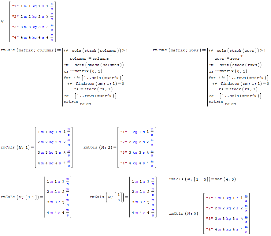

#3 Posted: 9/22/2022 7:02:40 AM
Something like this?
rmRows_rmCols.sm (35.17 KiB) downloaded 1271 time(s).

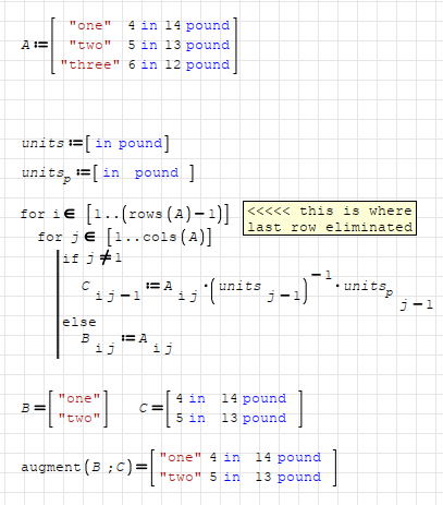

#4 Posted: 9/22/2022 11:16:00 AM
127 likes in 342 posts.
I believe that rfreund wanted to keep the units of measurement set. I take Davide's solution and I add a trick (I think he had been offered by Overlord or Razonar or perhaps from both).
However, I still have to solve for the strings. Furthermore, if we cancel the columns instead of the lines we should build the units of measurement of the matrix resulting with the same method.
rmRows_rmCols_units.sm (15.7 KiB) downloaded 1206 time(s).

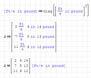

#5 Posted: 9/22/2022 7:14:03 PM
598 likes in 1,380 posts.
I first see usage of diag() for units by Razonar, then just wrote it as in your example.
Another way is using pseudo units, but this is also not interchangeable.
Again, these are not conventional ways. Just holding your left ear with your right hand.
And there is no solution for string column I guess.
matrix mixed units.sm (9 KiB) downloaded 1193 time(s).

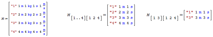

#6 Posted: 9/23/2022 4:26:49 AM
One might use vector-valued indices.
rmRows_rmCols_Kr.sm (7.87 KiB) downloaded 1229 time(s).

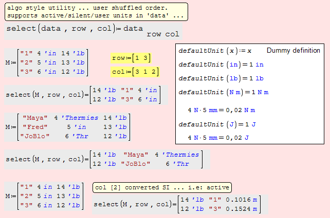

#15 Posted: 11/16/2022 8:51:17 AM
Yes, you can remove the row or column, but no you cannot get it to display in non-SI units.
Smath is delivered with silent units or active SI ...
... silent units as required
Page4 Delete Col-Row.sm (15.27 KiB) downloaded 1322 time(s).

#17 Posted: 11/17/2022 8:20:36 AM
Martin - I didn't realize that you could use "vector-valued indices" to reorganize matrices. That might be useful to me in the future. Although I suppose using the submatrix function is pretty similar.
The index vector approach is more flexible, as it allows to pick arbitrary subsets of rows and columns instead of continuous ranges.
iv.sm (4.1 KiB) downloaded 1204 time(s).
#18 Posted: 11/17/2022 11:38:10 AM
Jean - it took me a minute to understand "silent-units" as I thought the apostrophe in front of the unit solved the unit "display" issue. I guess it does if you only want it to "look correct". Thanks for your efforts.
Silent mode disables the SI unit sub-processor.
Don't miss visiting this great matrix shuffling utility.
Cheers ... Jean.
Utilities Matrix Shuffle.sm (12.31 KiB) downloaded 1207 time(s).
