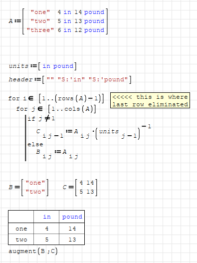

However, you can use a table region to show your new matrix.
Not an ideal solution, but it is what we can have.

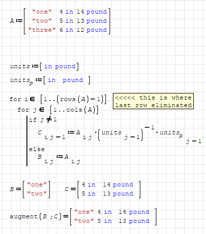

Something like this?
rmRows_rmCols.sm (35,17 КиБ) скачан 1271 раз(а).

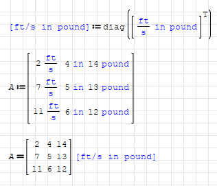

I first see usage of diag() for units by Razonar, then just wrote it as in your example.
Another way is using pseudo units, but this is also not interchangeable.
Again, these are not conventional ways. Just holding your left ear with your right hand.
And there is no solution for string column I guess.
matrix mixed units.sm (9 КиБ) скачан 1193 раз(а).

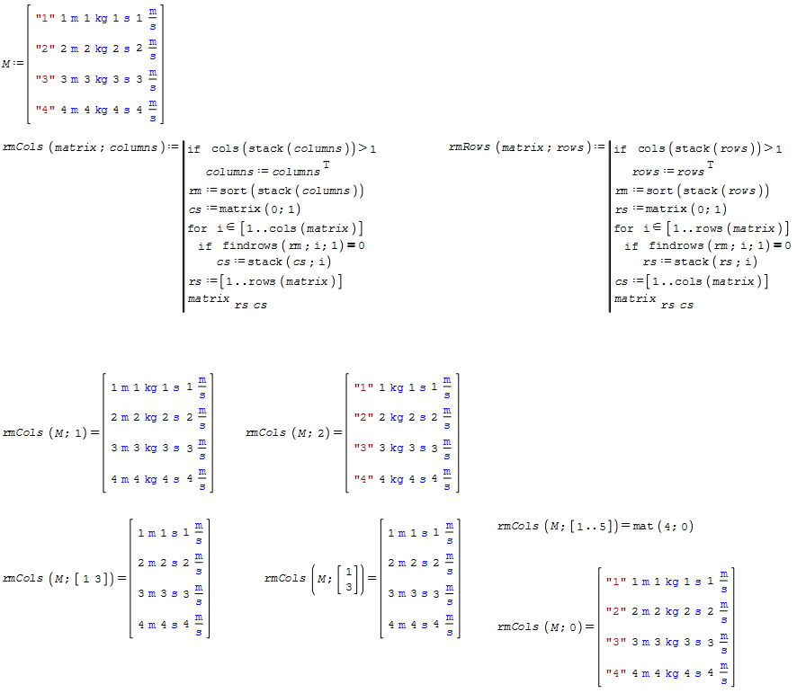

#6 Опубликовано: 23.09.2022 04:26:49

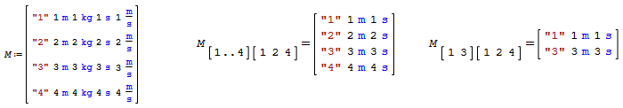

One might use vector-valued indices.
rmRows_rmCols_Kr.sm (7,87 КиБ) скачан 1229 раз(а).

#17 Опубликовано: 17.11.2022 08:20:36
Martin - I didn't realize that you could use "vector-valued indices" to reorganize matrices. That might be useful to me in the future. Although I suppose using the submatrix function is pretty similar.
The index vector approach is more flexible, as it allows to pick arbitrary subsets of rows and columns instead of continuous ranges.
iv.sm (4,1 КиБ) скачан 1202 раз(а).

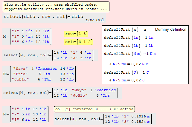

Silent mode disables the SI unit sub-processor.
Don't miss visiting this great matrix shuffling utility.
Cheers ... Jean.
Utilities Matrix Shuffle.sm (12,31 КиБ) скачан 1207 раз(а).
