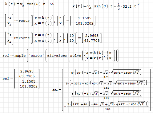

Good afternoon everyone.
I'm using the "roots" command, but I'm not getting the two points where the line intersects the parabola. The command gives me only one result and omits the other point. Attached is the file and image of the problem. How can I find both intersection points?

#2 Posted: 4/14/2023 5:35:21 PM
As doctored ... Jean
Roots Doctored.sm (9.38 KiB) downloaded 1302 time(s).
#3 Posted: 4/14/2023 6:41:21 PM
Hi Sergio. There are a 3 argument version of roots, where the third is a guess value for the root.
Roots.sm (9.84 KiB) downloaded 1332 time(s).

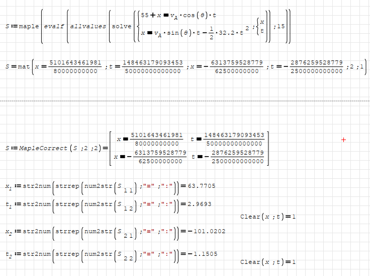

#5 Posted: 4/15/2023 7:31:34 PM
598 likes in 1,380 posts.
Here your solution solved with maple plugin.
No need to enter guess points for this.
Maxima can solve it too, similarly.
PS: MapleCorrect() function can be found here.
Assign() function can be used instead of str2num() + num2str() + strrep().

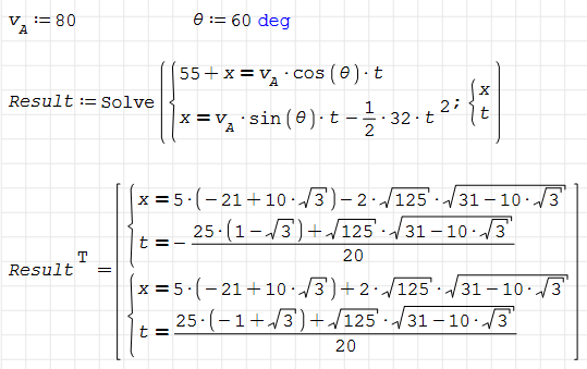

#6 Posted: 4/15/2023 8:44:04 PM
My personal favourite way to handle solver results is Davide's at() substitution function.
#7 Posted: 4/16/2023 2:49:20 AM
Hi. This is another way.
Roots.sm (16.66 KiB) downloaded 1289 time(s).

#10 Posted: 4/16/2023 6:34:02 PM
#11 Posted: 4/17/2023 1:44:30 AM
I found a Windows laptop.
And tried Maxima plugin Solve().
It can solve easily.
Alvaro 4/17/2023 5:27:00 PM
