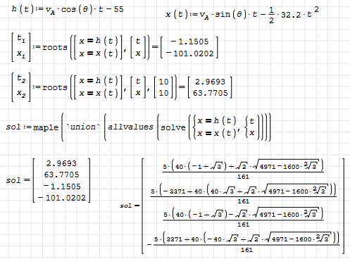

Good afternoon everyone.
I'm using the "roots" command, but I'm not getting the two points where the line intersects the parabola. The command gives me only one result and omits the other point. Attached is the file and image of the problem. How can I find both intersection points?
Roots.sm (8,44 КиБ) скачан 1294 раз(а).
Click to enlarge

#3 Опубликовано: 14.04.2023 18:41:21
Hi Sergio. There are a 3 argument version of roots, where the third is a guess value for the root.
Roots.sm (9,84 КиБ) скачан 1332 раз(а).

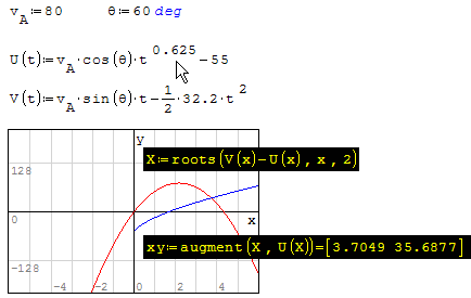

#4 Опубликовано: 15.04.2023 08:54:21
'roots' is essentially based on differentiable function.
Often, in Engineering works you don't have differentiable functions,
Gamma(x), spline fit ... etc.
In those cases, use the X(Φ,a,b,ε) utility.
Cheers ... Jean.
roots Gamma(x).sm (18,54 КиБ) скачан 1285 раз(а).

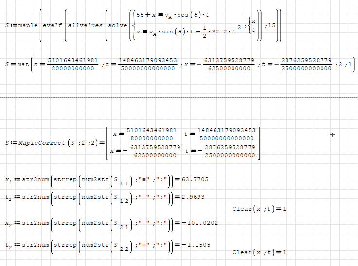

#5 Опубликовано: 15.04.2023 19:31:34
Here your solution solved with maple plugin.
No need to enter guess points for this.
Maxima can solve it too, similarly.
PS: MapleCorrect() function can be found here.
Assign() function can be used instead of str2num() + num2str() + strrep().

#8 Опубликовано: 16.04.2023 09:11:08
Many Smath built-in functions are not differentiable.
diff(▄ ▄) not defined ... Airy example attached.
roots Airy.sm (11,05 КиБ) скачан 1262 раз(а).

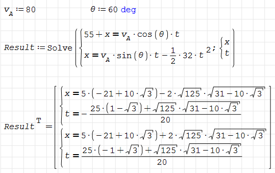

#11 Опубликовано: 17.04.2023 01:44:30
I found a Windows laptop.
And tried Maxima plugin Solve().
It can solve easily.
Alvaro 17.04.2023 17:27:00
