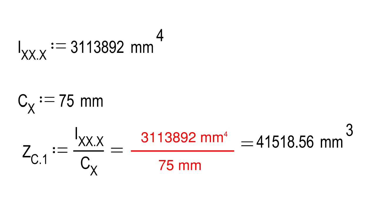

Hi all,
I want to show the amount of variations in the formulas, like the red part in the below image.
Currently Smath just calculates the result from the formula and does not show the amounts in the formula.
Can anyone help me with this?

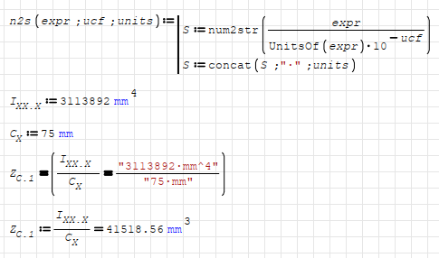

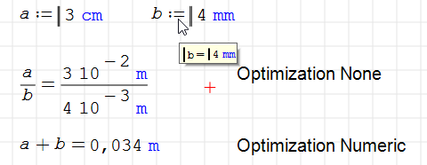

There is an ugly way to enforce storage of the given value "as is" - use the line operator.
Yet the best you get for display is the original numeric value with the original unit converted to base units. I don't see how the latter can be suppressed, yet, it should not be a principal design problem of SMath.
usim.sm (4.67 KiB) downloaded 1354 time(s).
