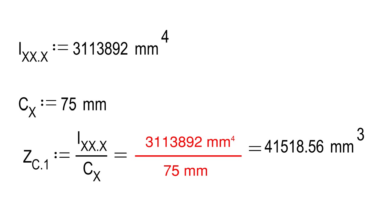

I want to show the amount of variations in the formulas, like the red part in the below image.
Currently Smath just calculates the result from the formula and does not show the amounts in the formula.
Can anyone help me with this?

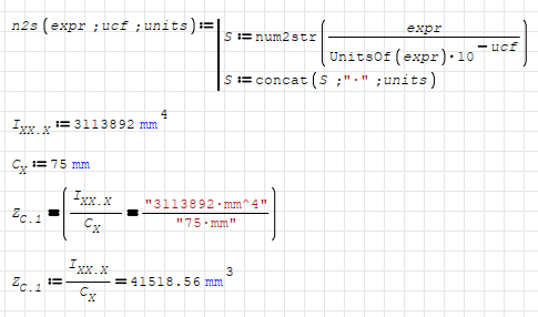

In example below there are a lot of confusing aspects.
I post it for you to show it can be done and check what is done.
It will not work for all situations however.
I will humbly suggest you to not seek showing amounts.
Especially if they contain units.
show_amounts.sm (5,58 КиБ) скачан 1317 раз(а).

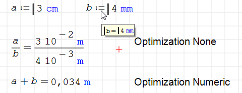

There is an ugly way to enforce storage of the given value "as is" - use the line operator.
Yet the best you get for display is the original numeric value with the original unit converted to base units. I don't see how the latter can be suppressed, yet, it should not be a principal design problem of SMath.
usim.sm (4,67 КиБ) скачан 1353 раз(а).
