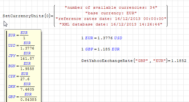

Hi all,
Here there is a plugin to have currencies and exchange rates in SMath Studio.
Infos:
Functions:
  • SetCurrencyUnits(1), SetCurrencyUnits(2): extends SMath Studio with currency units. When an internet connection is available, exchange rates are kept updated using the ECB reference rates (internet connection not required but useful);
    Quote
    The reference rates are usually updated by 3 p.m. C.E.T. They are based on a regular daily concertation procedure between central banks across Europe and worldwide, which normally takes place at 2.15 p.m. CET.
  • GetYahooExchangeRate(2): get a wide set of exchange rates from Yahoo Finance (internet connection required); service discontinued by Yahoo

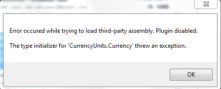

Unfortunately Davide, this does not work for me (Win7 x64). Plugin refuses to install properly.

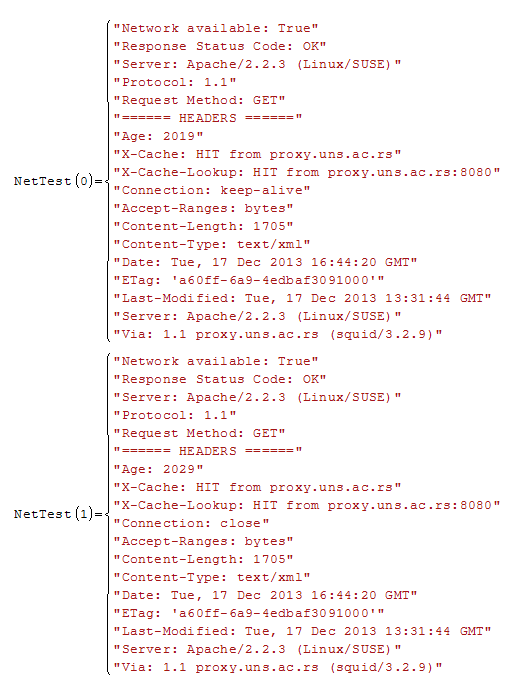

Try again, I've made some changes... If doesn't work try NetTest(0) and NetTest(1) and post a screenshot
very strange... try again with this update; if doens't work got to %APPDATA%\SMath\Debug\CurrencyUnits and post the log file

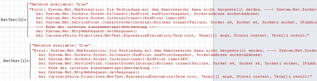

#7 Posted: 12/17/2013 8:41:16 AM
1,355 likes in 2,270 posts.
The results were overly wide, thus i cut them.
#8 Posted: 12/17/2013 8:41:47 AM
Failed again
Here is the log file
log.txt (1.76 KiB) downloaded 1275 time(s).
#9 Posted: 12/17/2013 11:09:29 AM
1,443 likes in 2,935 posts.
seems a proxy/firewall authorization problem... I suppose that NetTest("http://www.google.com") and NetTest("http://www.google.de") will produce the same results

#10 Posted: 12/17/2013 1:31:12 PM
It seems that this plugin is not going to install into the Martins' unofficial build. I figured out by the second line of the log file.
I tried it on the official one and it seems to be Ok

#11 Posted: 12/17/2013 1:52:02 PM
thank you Radovan, now I understand
the plugin looks for the files in the %APPDATA% folder, I'll try to fix it
[EDIT] UPDATED: this version should work properly both in the official and the unofficial versions

Better now, but still no connectivity. I guess that is sort of firewall or proxy issue.
In our school LAN, the connectivity is broken, at home web access works (official and unofficial version). I shall include the plugin in the next release of the inofficial distribution.
