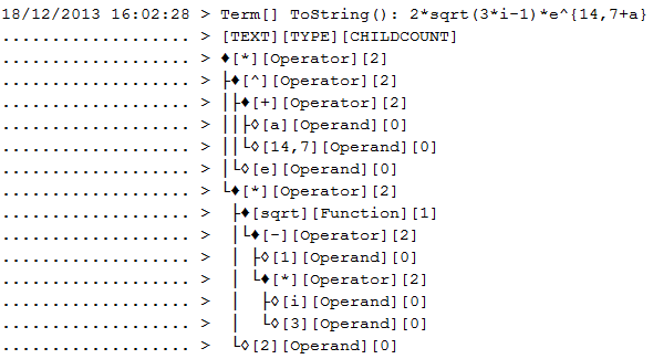

UPDATED
- error handling: LOGs will be placed in the relative "extensions\debug\CurrencyUnits" folder (so the portable version has a portable debug path)
- For developers only: added a log tool to output a Term[] tree representation (see the CurrencyUnits Implementer.cs).
2013-12-18 17_05_51-C__Users_Davide_AppData_Roaming_SMath_extensions_debug_CurrencyUnits_log.txt - N.png
