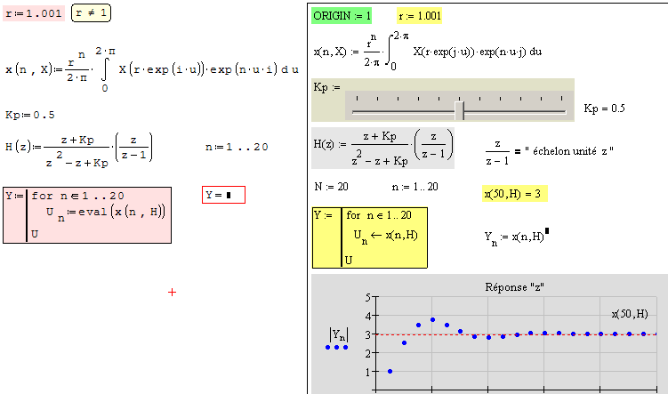

#1 Posted: 12/10/2018 1:39:00 PM
Can't manage this otherwise than shitting bricks !
Solution is welcomed ... Thanks
Done otherwise to rescue the Document.
Inst_PID Discrete Schema EXAMPLE_6 Failed.sm (36.61 KiB) downloaded 1198 time(s).
#2 Posted: 12/10/2018 2:15:29 PM
Fridel Selitsky
Fridel Selitsky
520 likes in 451 posts.
Tiny fix
Inst_PID Discrete Schema EXAMPLE_6.sm (39.17 KiB) downloaded 1165 time(s).

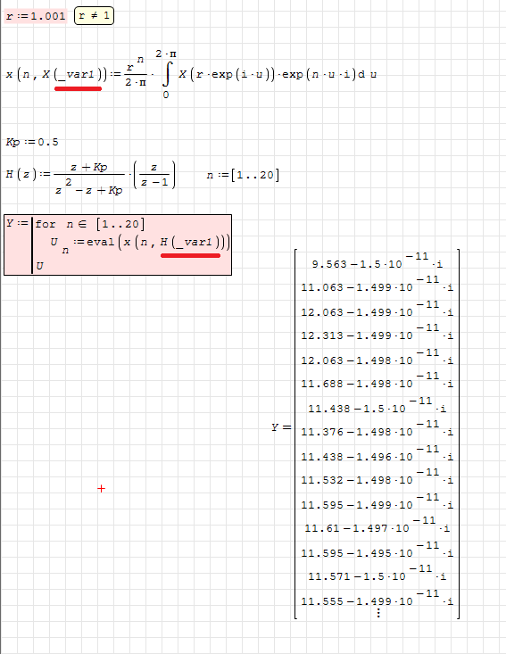

In order to pass functions as inputs to other functions you need to declare it as such and pass a "dummy" variable. See following.
There is still a problem in that it is not evaluating properly, I believe.
Inst_PID Discrete Schema EXAMPLE_6_Partlyfixed..sm (44.75 KiB) downloaded 1184 time(s).

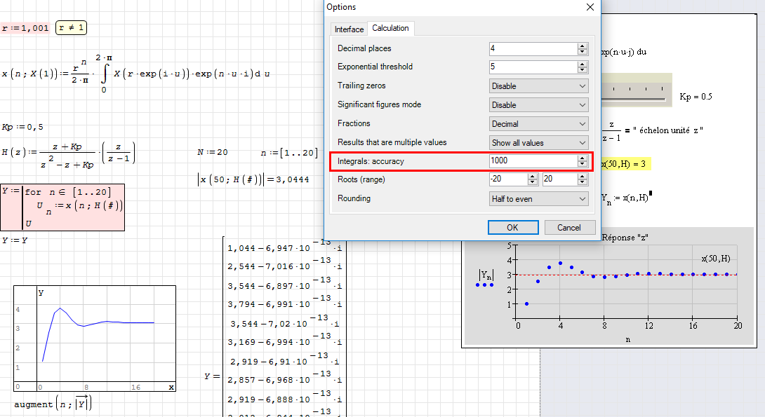

#4 Posted: 12/10/2018 8:29:36 PM
fixed
Inst_PID Discrete Schema EXAMPLE_6 - fixed.sm (46.19 KiB) downloaded 1216 time(s).
2018-12-11 00_34_33-SMath Studio - [Inst_PID Discrete Schema EXAMPLE_6 - fixed.sm].png
  • removed answer requested for first argument of the last system;
  • used f(number_of_arguments) function of function argument (more elegant, point out that the variable name doesn't matter);
P.S. To obtain similar results, change the integration accuracy to something higher than 100
2018-12-11 00_53_52-SMath Studio - [Inst_PID Discrete Schema EXAMPLE_6 - fixed.sm_].png

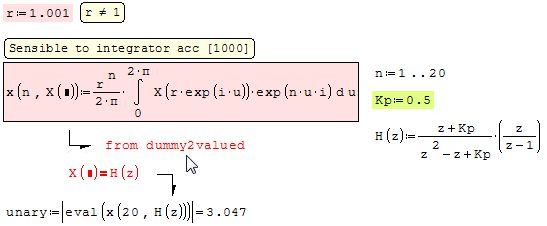

Dumb question maybe, but how do you get the '#' to show up in the H(#) function call?
#6 Posted: 12/11/2018 12:50:47 AM
As simple as that: x(n,X(▄)) ... simply the native dummy argument
big square imitation Alt220 ... try it.
Thanks all you Doctors ! Just refreshing that huge collection
of PID examples, coming soon.
#7 Posted: 12/11/2018 1:04:47 AM
... like this:
#8 Posted: 12/11/2018 4:44:48 AM
CTRL+K then #
:d
another option, yes

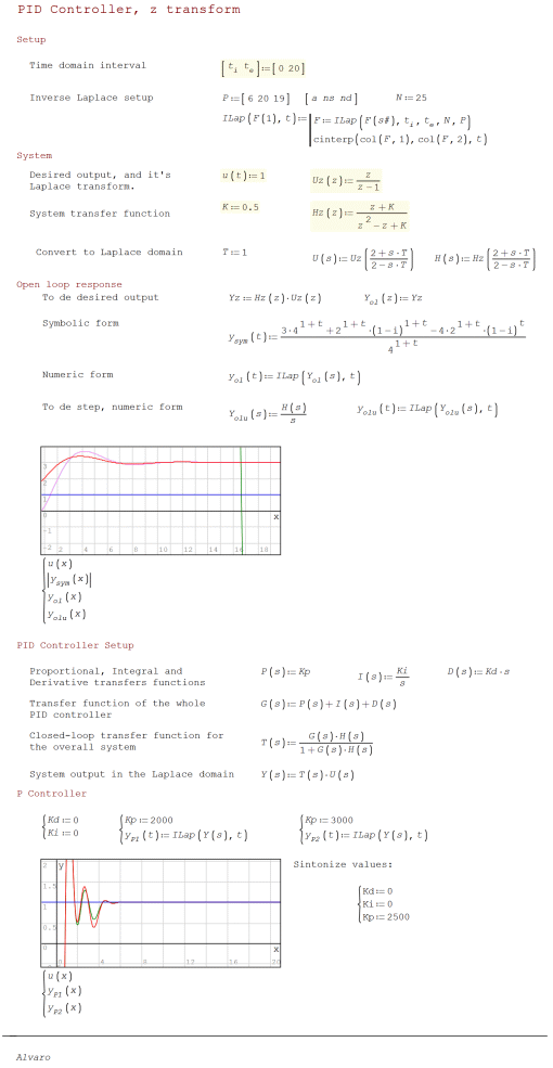

#9 Posted: 12/13/2018 7:02:18 PM
Hi. This is the setup for use inverse laplace transform for numerically evaluate the response for a system in z domain.
pid_controler z.sm (50 KiB) downloaded 1196 time(s).
