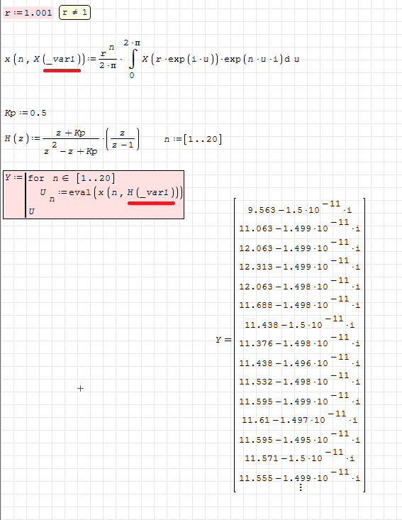

Can't manage this otherwise than shitting bricks !
Solution is welcomed ... Thanks
Done otherwise to rescue the Document.
Inst_PID Discrete Schema EXAMPLE_6 Failed.sm (36,61 КиБ) скачан 1198 раз(а).
WroteCan't manage this otherwise than shitting bricks !
In order to pass functions as inputs to other functions you need to declare it as such and pass a "dummy" variable. See following.
There is still a problem in that it is not evaluating properly, I believe.
Inst_PID Discrete Schema EXAMPLE_6_Partlyfixed..sm (44,75 КиБ) скачан 1184 раз(а).

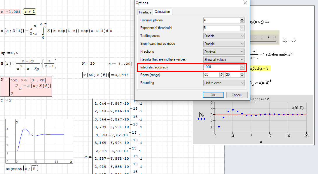

frapuano 10.12.2018 16:55:00
fixed
Inst_PID Discrete Schema EXAMPLE_6 - fixed.sm (46,19 КиБ) скачан 1216 раз(а).
![2018-12-11 00_34_33-SMath Studio - [Inst_PID Discrete Schema EXAMPLE_6 - fixed.sm].png](/ru-RU/files/Download/xLgXx6/2018-12-11-00_34_33-SMath-Studio---[Inst_PID-Discrete-Schema-EXAMPLE_6---fixed.sm].png)
P.S. To obtain similar results, change the integration accuracy to something higher than 100
![2018-12-11 00_53_52-SMath Studio - [Inst_PID Discrete Schema EXAMPLE_6 - fixed.sm_].png](/ru-RU/files/Download/pwH7T5/2018-12-11-00_53_52-SMath-Studio---[Inst_PID-Discrete-Schema-EXAMPLE_6---fixed.sm_].png)

- removed answer requested for first argument of the last system;
- used f(number_of_arguments) function of function argument (more elegant, point out that the variable name doesn't matter);

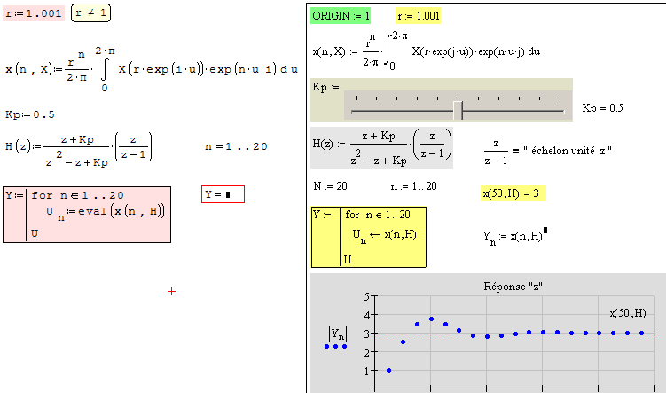

Arie 10.12.2018 20:37:00
Wrotefixed

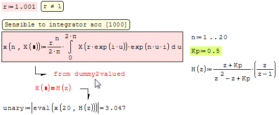

Dumb question maybe, but how do you get the '#' to show up in the H(#) function call?
WroteDumb question maybe, but how do you get the '#' to show up in the H(#) function call?
As simple as that: x(n,X(▄)) ... simply the native dummy argument
big square imitation Alt220 ... try it.
Thanks all you Doctors ! Just refreshing that huge collection
of PID examples, coming soon.
CTRL+K then #
:d
Wrotebig square imitation Alt220
another option, yes

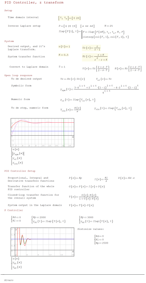

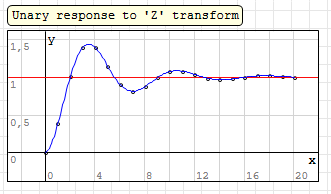

Hi. This is the setup for use inverse laplace transform for numerically evaluate the response for a system in z domain.
pid_controler z.sm (50 КиБ) скачан 1196 раз(а).
