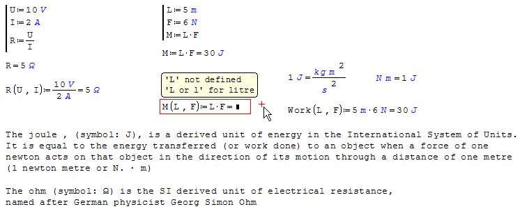

#3 Posted: 5/26/2016 9:38:23 PM
983 likes in 6866 posts.

#6 Posted: 10/25/2016 9:27:44 PM
Can anyone advise if it would be feasible to write an extension to accomplish this?
Your 2nd option is redundant. It has no interest in applied
Scientific/Engineering works. Why sould it be of some use
otherwise [teaching/Edu/publishing ...].
That's my answer, not my business.

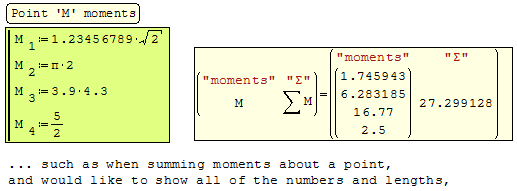

#9 Posted: 10/26/2016 2:04:19 PM
To the wording of your thread "Evaluation of a formula with units"
That is the task of symbolic, that's why the red snippet in my reply.
In Professional works, we define/indentify the contex/units ...
then produce the document(s).
I don't understand your zillions pages long formula.
I don't understand /One page later, /Two pages later,/Three pages later
Attach something: collabs will read .

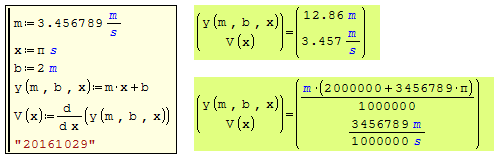

#11 Posted: 10/27/2016 12:51:36 PM

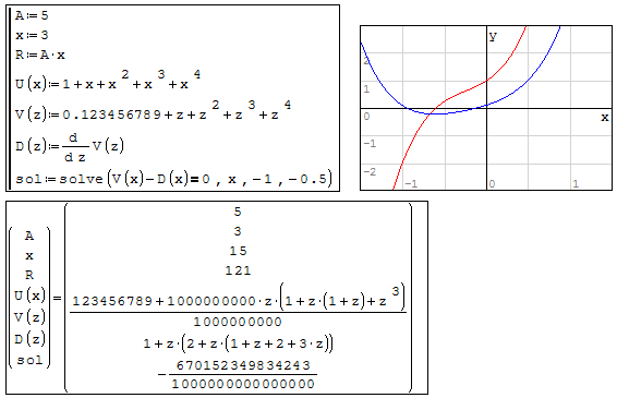

#13 Posted: 10/29/2016 9:24:25 AM
#14 Posted: 10/29/2016 9:31:59 AM
#15 Posted: 10/29/2016 9:55:20 AM
That thread goes nowhere w/o productive demand.
