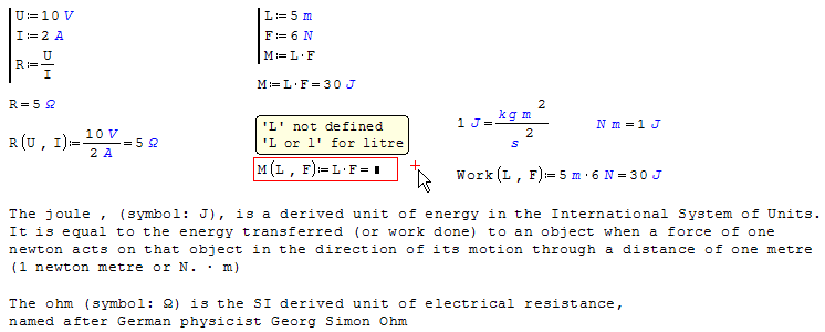

#3 Posted: 5/26/2016 9:38:23 PM

#6 Posted: 10/25/2016 9:27:44 PM
Can anyone advise if it would be feasible to write an extension to accomplish this?
Your 2nd option is redundant. It has no interest in applied
Scientific/Engineering works. Why sould it be of some use
otherwise [teaching/Edu/publishing ...].
That's my answer, not my business.

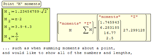

Jean, thank you for your efforts. You are showing everything one one screen, but try to imagine the following.
Quote
L = 5 m
F = 6 N
M = L x F = 5 m x 6 N = 30 J
/One page later
/Two pages later
/Three pages later
q = 3
L1 = q x L = 3 x 5 m = 15 m
What you are suggesting defeats the purpose of using a program like SMath because that can be easily achieved in Excel. What you are showing (twice now) is not the same as what is being requested, it is very different, that's why two different people on two different occasions have asked for something despite your previous example. What we want is clearly shown. Following your example, we either 1) have to re-show the variables prior to each calculation, or 2) redefine the variables prior to each calculation, or 3) redefine the equation prior to each calculation.
Regarding the equation being broken up over three lines (symbolic, numeric, result), that form absolutely is used in applied engineering. If you have a very long equation, such as when summing moments about a point, and would like to show all of the numbers and lengths, it is very cumbersome to have a gigantic equation on one line; you would likely have to adjust your page width to fit such a formula or break it up into multiple separate formulas, which again, for my needs, defeats the purpose of using a program like SMath.
In short, my question still stands.
If it is feasible, I would try to code it, but I want to make sure there's no inherent conflict with SMath that would make it impossible to do so.

#9 Posted: 10/26/2016 2:04:19 PM
To the wording of your thread "Evaluation of a formula with units"
That is the task of symbolic, that's why the red snippet in my reply.
In Professional works, we define/indentify the contex/units ...
then produce the document(s).
I don't understand your zillions pages long formula.
I don't understand /One page later, /Two pages later,/Three pages later
Attach something: collabs will read .

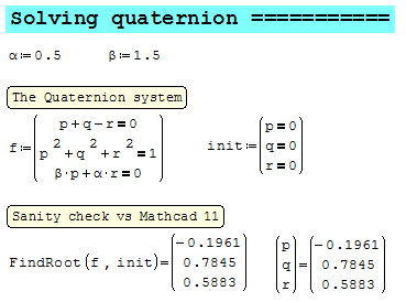

#11 Posted: 10/27/2016 12:51:36 PM

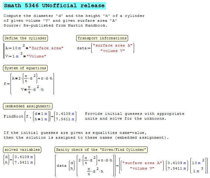

#13 Posted: 10/29/2016 9:24:25 AM

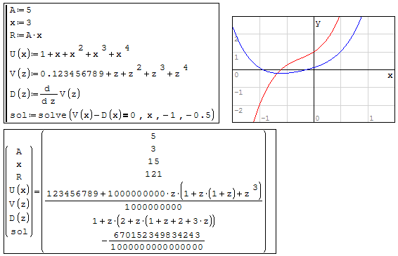

#14 Posted: 10/29/2016 9:31:59 AM

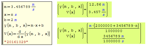

#15 Posted: 10/29/2016 9:55:20 AM
That thread goes nowhere w/o productive demand.
