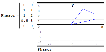

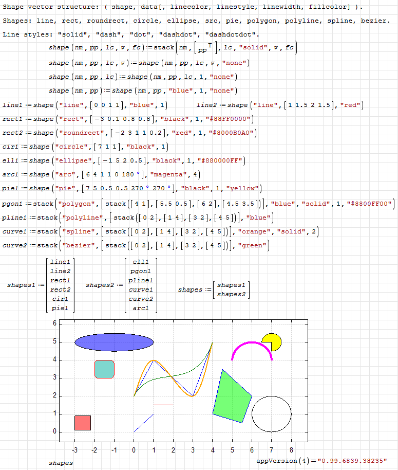

I need to draw phasors (lines-vectors) for AC circuit analysis.
- Line from origin to a point.
- Line from a point to another
The magnitude and the angle or Real and Imaginary parts are known.
Is there any related example?
Thank you,
Basile

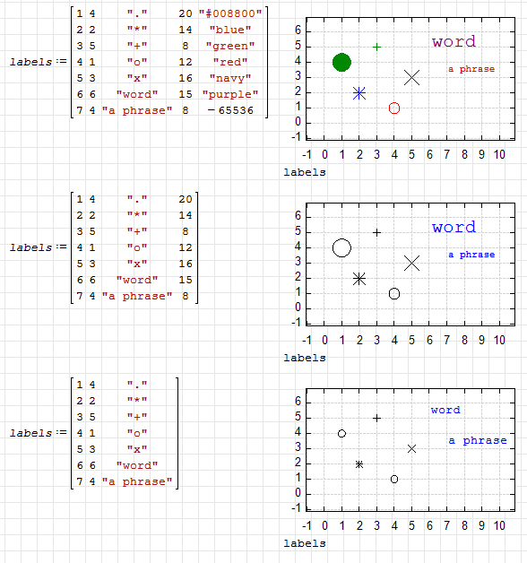

#4 Posted: 5/20/2019 2:25:58 AM
1,555 likes in 1,867 posts.
You can use X-Y Plot Region for this.
XYPlot. Draw shapes.sm (19.85 KiB) downloaded 3150 time(s).
XYPlot. Draw shapes.pdf (92.91 KiB) downloaded 2146 time(s).

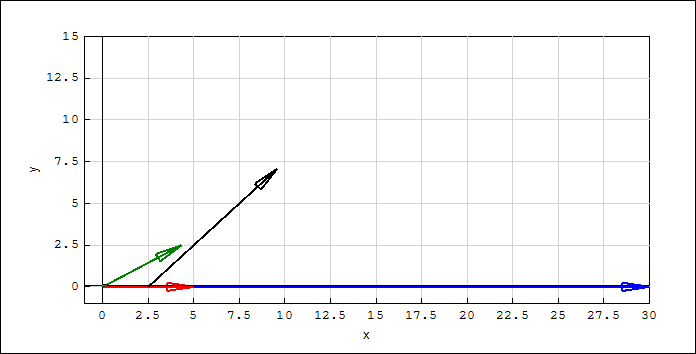

#8 Posted: 5/23/2019 8:32:28 PM
What are the red squares to the right?
Red square in the scroll bar points at the errors in the document.
More elegant arrows proposed.
Page2-error.sm (8.34 KiB) downloaded 1322 time(s).

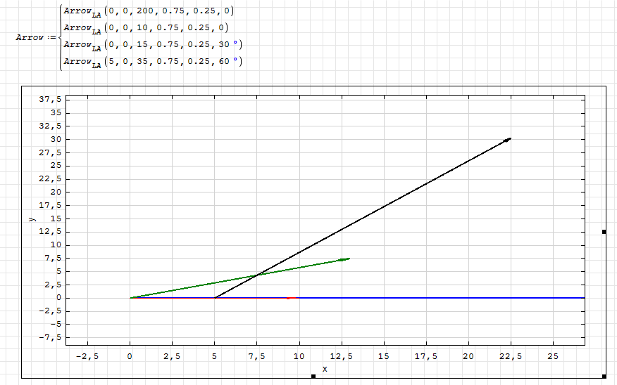

Hi Jean,
The arrows fail when the length of the vector changes.
I have tried as a percentage of length but does not look nice.
Scaling the vectors to always be one but will loose real valuesSMath-1.PNG.
Any good idea?
Is there a way to auto-scale the 2D plot or X-Y plot?
One of the vectors is out of the visual plane.
Thanks,
Basile
#10 Posted: 5/24/2019 3:19:13 PM
As I said before:
How about a simple arrow?
I do not know how to do it better. The arrow should look good in different scales and in its own size.
#11 Posted: 5/24/2019 5:35:33 PM
Any good idea?
None of the quick plot or X_Y plot can be made X, Y directions scalable
similar to Mathcad 11 ... to me: useless.
From an original X_Y plot creation, stretch by handles respect aspect ratio.
If you modify the X, Y directions [max/min], apply close enough HL, HW ratio.
Page2-error (1).sm (11.66 KiB) downloaded 1337 time(s).

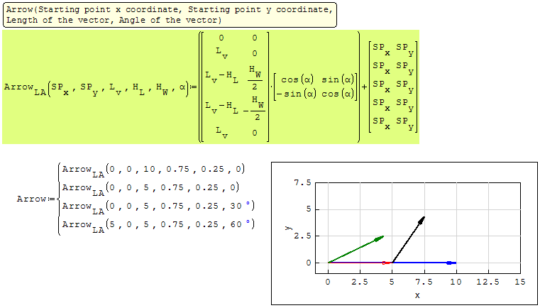

#12 Posted: 5/24/2019 10:44:11 PM
Fridel Selitsky
Fridel Selitsky
520 likes in 451 posts.
Another kind of arrow.
Arrow.sm (5.46 KiB) downloaded 1103 time(s).

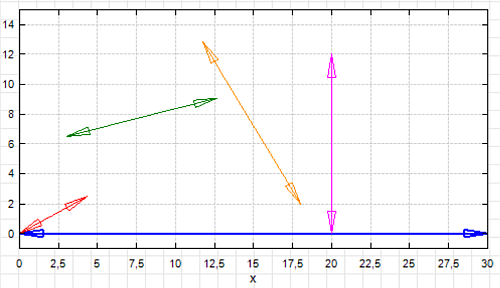

#13 Posted: 5/25/2019 9:24:37 PM
NDTM Amarasekera
NDTM Amarasekera
130 likes in 352 posts.
With both arrow heads, based on Jean's method.
Thank you Jean.
Both Arrows.sm (30.49 KiB) downloaded 1133 time(s).
