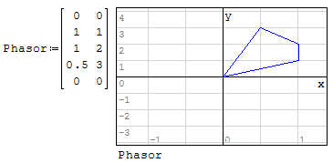

I need to draw phasors (lines-vectors) for AC circuit analysis.
- Line from origin to a point.
- Line from a point to another
The magnitude and the angle or Real and Imaginary parts are known.
Is there any related example?
Thank you,
Basile

#4 Опубликовано: 20.05.2019 02:25:58
1 554 сообщений из 1 864 понравились пользователям.
You can use X-Y Plot Region for this.
XYPlot. Draw shapes.sm (19,85 КиБ) скачан 2949 раз(а).
XYPlot. Draw shapes.pdf (92,91 КиБ) скачан 1988 раз(а).

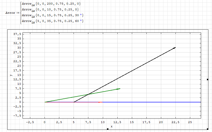

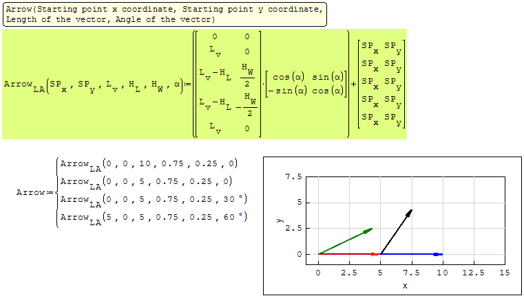

The arrows fail when the length of the vector changes.
I have tried as a percentage of length but does not look nice.
Scaling the vectors to always be one but will loose real valuesSMath-1.PNG.
Any good idea?
Is there a way to auto-scale the 2D plot or X-Y plot?
One of the vectors is out of the visual plane.
Thanks,
Basile
#10 Опубликовано: 24.05.2019 15:19:13
As I said before:
How about a simple arrow?
I do not know how to do it better. The arrow should look good in different scales and in its own size.

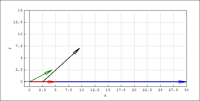

#11 Опубликовано: 24.05.2019 17:35:33
Any good idea?
None of the quick plot or X_Y plot can be made X, Y directions scalable
similar to Mathcad 11 ... to me: useless.
From an original X_Y plot creation, stretch by handles respect aspect ratio.
If you modify the X, Y directions [max/min], apply close enough HL, HW ratio.
Page2-error (1).sm (11,66 КиБ) скачан 1204 раз(а).

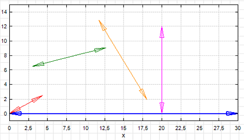

NDTM Amarasekera
NDTM Amarasekera
More elegant arrows proposed.
With both arrow heads, based on Jean's method.
Thank you Jean.
Both Arrows.sm (30,49 КиБ) скачан 1017 раз(а).
