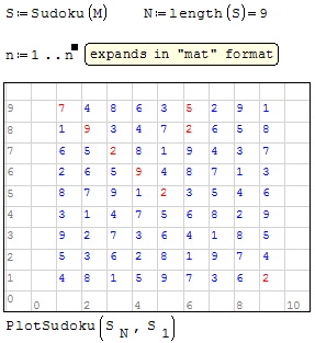

Hi. This other version stores all the intermediate steps in the brute force algorithm, but I fail trying to animate it. Hope someone else can do it.

#26 Posted: 9/5/2019 10:29:54 AM
WroteHi. This other version stores all the intermediate steps in the brute force algorithm, but I fail trying to animate it. Hope someone else can do it.
Thanks Alvaro for that gorgeous piece of work !
The "mat" style [n:=1..9] may have other applications ?
As it looks: left over from very original Smath versions.
In many instances SS 5346 needed mat2sys conversions
#27 Posted: 9/5/2019 11:55:01 AM
It's not an animation, but adding a Slider Region makes it easier to see solutions
SudokuBruteForceAnimated_lyles_raz_s.sm (25.18 KiB) downloaded 1085 time(s).

#28 Posted: 9/5/2019 12:18:58 PM
WroteIt's not an animation, but adding a Slider Region makes it easier to see solutions
Thanks Sergio ... near to RIP [I mean Sleep in Pace]
