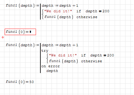

To better illustrate what I think is happening I've created the following worksheet. The first function definition is just a simple function that calls itself recursively until its 200th call at which point it exits. However, when run it experiences the same error as we see in the sudoku.sm. I rewrote the function using a try/on error and we see we only get to 50 iterations before it fails.

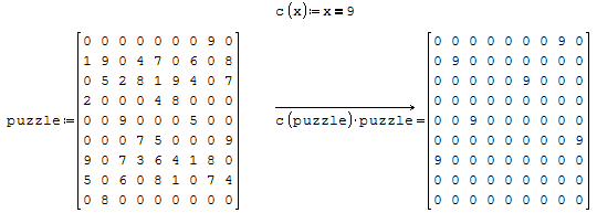

I think it's possible to fill the '0' positions of the 9x9 Sudoku
with random not common to the existing filled position.
Filling one col at time, collect ...

I remember this limitation was introduced some time ago to avoid unintentional hard crashes on wrong formed algorithms; considering that any recursive algorithm can be made iterative, you probably have to design it in another way or find a different code

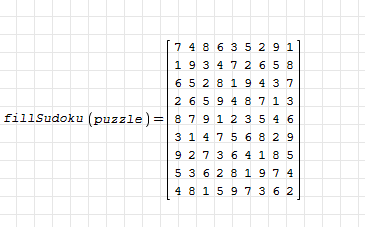

#20 Posted: 9/2/2019 11:14:14 PM
Hi. Here, the mathcad 11 version for the recursive method. Notice that mathcad don't pass values by reference, only by value, so the matrix can't be modified inside the fucntion, only 'outside'. Also, mathcad have the return function as keyword but isn't used.
SudokuRec.zip (24.01 KiB) downloaded 352 time(s).
SudokuRec.pdf (285.89 KiB) downloaded 664 time(s).
This other is te recurrent version in SMath: don't works.
SudokuRec.sm (45.18 KiB) downloaded 1060 time(s).
This other is a rewrite of the alyles version.
SudokuBruteForce_lyles.sm (43.51 KiB) downloaded 1092 time(s).
