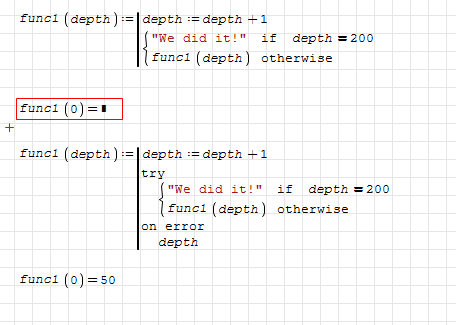

To better illustrate what I think is happening I've created the following worksheet. The first function definition is just a simple function that calls itself recursively until its 200th call at which point it exits. However, when run it experiences the same error as we see in the sudoku.sm. I rewrote the function using a try/on error and we see we only get to 50 iterations before it fails.
recursion.sm (4,13 КиБ) скачан 1004 раз(а).

This looks to correlate to a depth of ~21 or 22 levels of recursion no matter the starting puzzle.
What I understood considering your last messages, you think there is nothing significant wrong with the code itself. Problem is SMath handling of recursions.

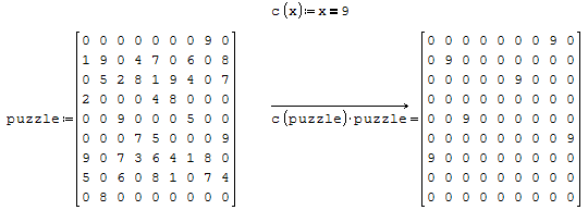

#10 Опубликовано: 30.08.2019 19:41:02
I think it's possible to fill the '0' positions of the 9x9 Sudoku
with random not common to the existing filled position.
Filling one col at time, collect ...

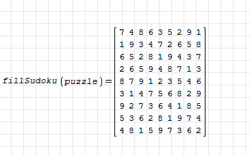

As Davide said, you don't have to do it recursively.
It may be slow, but it works. Might be able to optimize for better performance.
sudoku_lyles2.sm (28,25 КиБ) скачан 1011 раз(а).

Well it works for the first two puzzles at least. Having issues with the third. Haven't tried the fourth....
It's a start
#14 Опубликовано: 31.08.2019 12:42:16
NDTM Amarasekera
NDTM Amarasekera
It works for the fourth, but fails for the third puzzle.

Don't bother about it. I found these sudoku's on internet without checking them.
I checked that puzzle with C code right now and it has no solution.
You mean puzzle 3 has no solution ?
Solution is => give to champions.
Attached utilities may be useful otherwise.
Mathemtica 4.0 "recursion limit" is pure jargon.
In some program, if/otherwise does not work [if/else = YES].
Is there a catch wrt puzzle 3 ... Watson ?
Utilities Matrix Count in Soduku.sm (22,13 КиБ) скачан 1071 раз(а).
