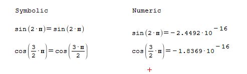

Hello.
I find buf for sine and cosine functions.
Ex.) sin(2*pi)=-2.4492170e-16
cos(3/2*pi)=-1.83690e-16
Check please.
Thanks in advanced.
There is no bug: sin(2pi)=0

I agree with DHKIM about this is a bug.
For example, it invalidate my favorite integer question function:
which I use from Derive for DOS, who knows the exact answer:
#4 Posted: 3/19/2018 8:45:27 AM
This situation is common in many more types of result.
There should be a work sheet option to assign mathematical '0'.
Long time ago, I claimed for this option.
