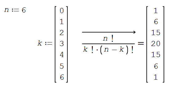

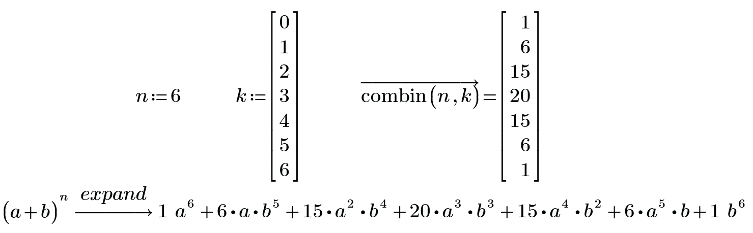

Can I do this with SMath/
See please Mathcad

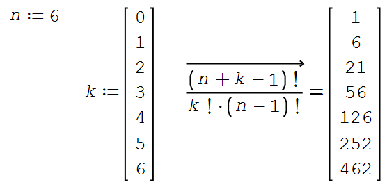

I know how create the first part. Has SMath the expand operator or some one?
#3 Posted: 6/19/2023 12:21:12 PM
Can I do this with SMath ?
Smath offers more.
Maths Combine.sm (76.61 KiB) downloaded 1279 time(s).

Thanks!
But this
#5 Posted: 6/19/2023 12:32:28 PM

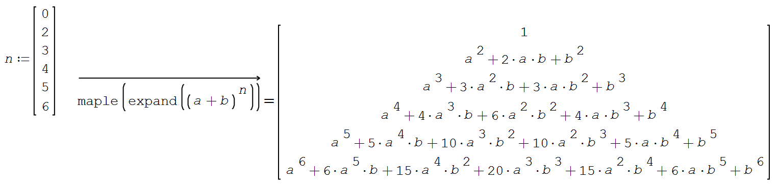

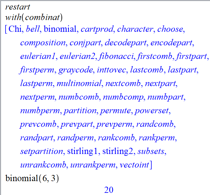

Can I have the combin from Maple?

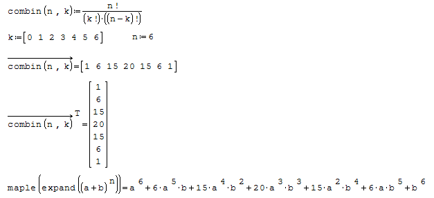

#7 Posted: 6/19/2023 12:40:56 PM
Your two demands honored.

But this Maple-function not work in SMath?

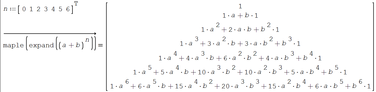

#10 Posted: 6/19/2023 6:23:49 PM
Pascal triangle
Maths Pascal Triangle QUICK.sm (48.15 KiB) downloaded 1220 time(s).

#12 Posted: 6/21/2023 5:36:00 AM
1,555 likes in 1,867 posts.
Оно работает, только нужно в папке с плагином дополнить with.inc файл. Там содержится список пакетов, которые подключаются при вызове функции maple(). Заранее неизвестно что понадобится пользователю, поэтому список подключаемых пакетов ограничен и настройка их списка осуществляется внешним файлом.

#14 Posted: 6/21/2023 11:41:59 AM
Pascal triangle
Fully automated.
Maths Pascal Auto Companion Copy.sm (36.62 KiB) downloaded 1211 time(s).

#17 Posted: 6/21/2023 4:06:18 PM
Usually, when working with Maple, you need to specify the name of the used package using the with() keyword.
To simplify the work with the maple() function, I make an indication of the packages used implicitly. When calling a function, a certain set of packages is always added.
These packages are listed as commands in the with.inc file. This text file is located in the Maple Tools plugin folder. In one of the subfolders (it seems bin).
You need to add the following text to the contents of the file:
with(combinat):
After adding this line, it will be possible to call functions from this package.

#19 Posted: 6/22/2023 5:25:34 AM
Is that custom set of packages somehow stored in the document metadata?
No. Indeed, this will work only locally.
The function can be called like this

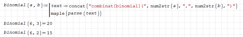

#20 Posted: 6/22/2023 10:49:51 AM
How do you add this to the plugin? Could you show this ?
Does binomial work on your system ?
Maths Pascal Auto Companion QUICK.sm (4.89 KiB) downloaded 1232 time(s).
