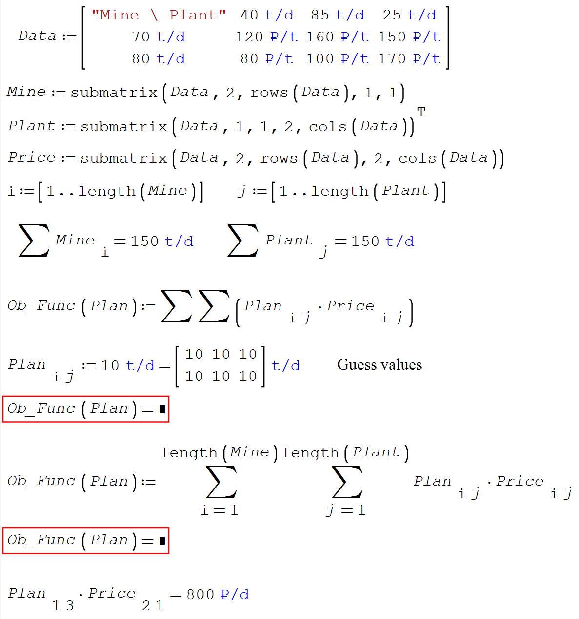

See please the picture and the attach
Transport-b.sm (13.63 KiB) downloaded 1483 time(s).

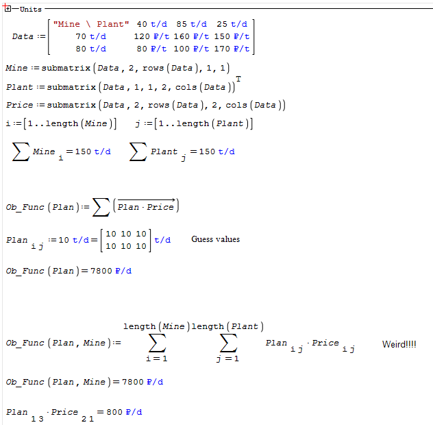

Like so?
Transport-c.sm (14.58 KiB) downloaded 1495 time(s).

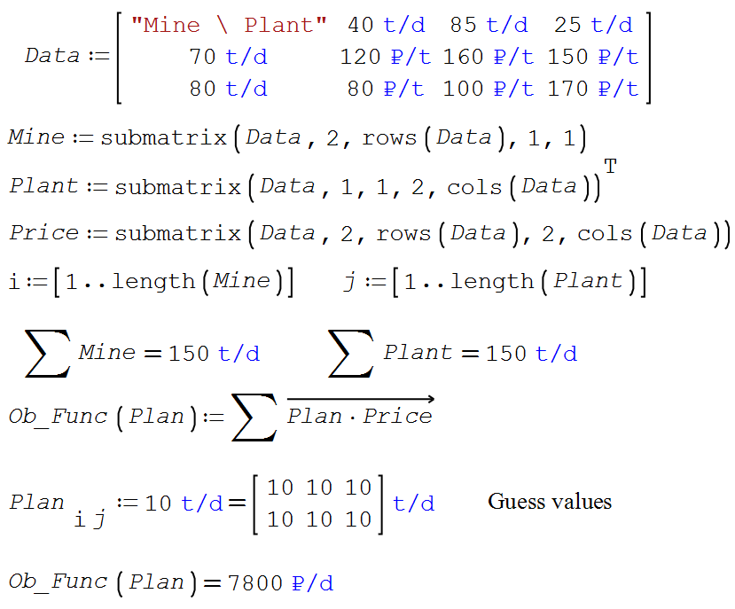

Valery Ochkov 9/4/2024 12:10:00 AM
#3 Posted: 9/4/2024 12:16:19 AM
Valery Ochkov
Valery Ochkov
66 likes in 697 posts.
Transport-d.sm (11.2 KiB) downloaded 1477 time(s).
