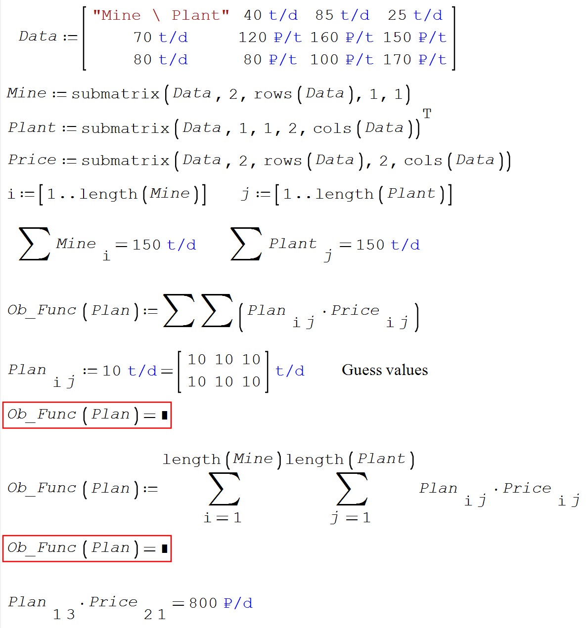

See please the picture and the attach

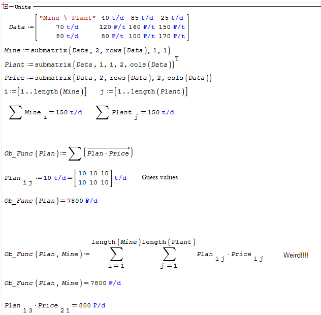

Like so?
Transport-c.sm (14,58 КиБ) скачан 1495 раз(а).
