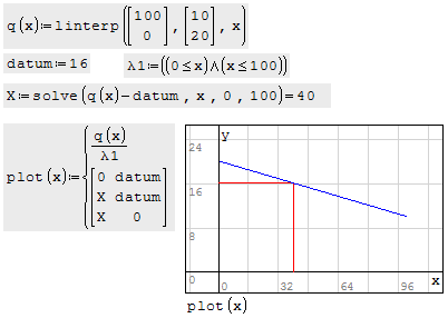

I made a sample with two different plots.
You can use them by changing variables.
DPT_NV plot.sm (11.08 KiB) downloaded 1277 time(s).

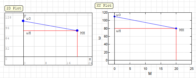

#4 Posted: 2/26/2023 5:33:26 PM
TwoPointsPlot.sm (11.84 KiB) downloaded 1256 time(s).

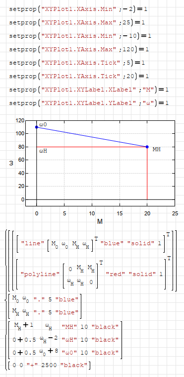

#6 Posted: 2/26/2023 9:21:08 PM
You can also use line and polyline commands for plot.
They work only in XYPlot, but sometimes they make everything easy.
There is also a setprop() function.
It can change format of your XYPlot automatically.
Search setprop() in forum for further information.
DPT_NV plot.sm (20.47 KiB) downloaded 1439 time(s).

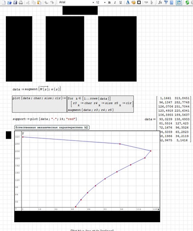

I tried: vector M(s) ω(s) "." 15 "blue"
but the application immediately crashes.
AD.sm (20.17 KiB) downloaded 1235 time(s).
Is it possible to make the graph automatically scale to the new values?
And does someone use android version of Smath (from this site)? I can't edit any of these files there.
One more question:
if I have a graph (attached file), then how do I mark the points along which it passes?

WroteIf I have a graph (attached file), then how do I mark the points along which it passes?
As in the attached.
Instead of re-scaling the same graph, plots all new graph on the same plot.
You will scale to accommodate for the larger graph.
AD Plot Points.sm (104.39 KiB) downloaded 1323 time(s).

#9 Posted: 2/27/2023 11:29:43 AM
#10 Posted: 2/27/2023 1:38:10 PM
WroteIs there any simple way to add the pass points and autoscale a graph?
Some Smath versions decided that opening in other versions will be black.
1. Open this document
2. If black, select by groups, click on background white
3. Make the all document as per 2. directive
4. at this point, you have recovered my original
5. Plot points and more advanced.
AD Plot Points TopUser2000.sm (87.24 KiB) downloaded 1244 time(s).

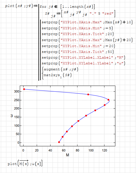

#11 Posted: 2/27/2023 1:57:37 PM
You can use this, XYPlot region is suitable.
One custom function to plot everything.
It also autoscale the graph.
AD.sm (28.23 KiB) downloaded 1214 time(s).
