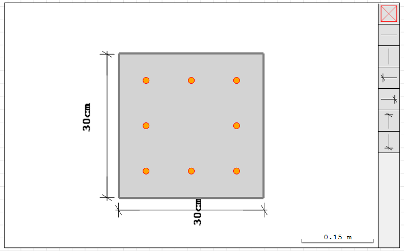

Hi, I want to set my label to vertical dimension but when I rotate the text it gets distorted, please how can I fix it?

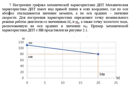

Tell me, please, if I have two points, then how can I plot a graph between them? According to my assignment, I need to build several graphs, but I do not know how to do it in the program. I have done the calculations, but for the rest I ask for help from local experts. I attach a sheet with the task and a file with calculations (sorry, that's in Russian). Can someone help me figure it out here?

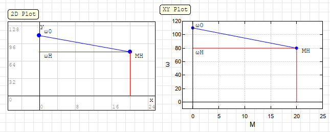

#3 Опубликовано: 26.02.2023 14:31:43
I made a sample with two different plots.
You can use them by changing variables.
DPT_NV plot.sm (11,08 КиБ) скачан 1277 раз(а).
TopUser2000 26.02.2023 15:06:00
#4 Опубликовано: 26.02.2023 17:33:26
TwoPointsPlot.sm (11,84 КиБ) скачан 1256 раз(а).
TopUser2000 27.02.2023 05:03:00

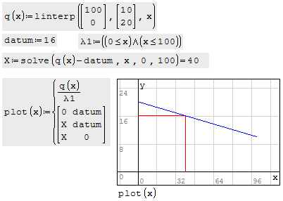

#6 Опубликовано: 26.02.2023 21:21:08

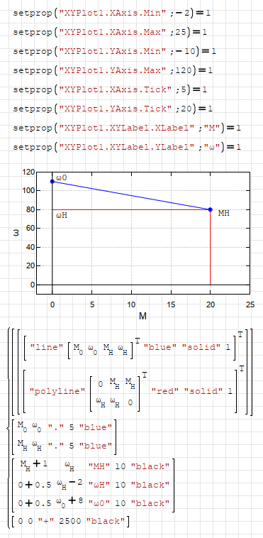

You can also use line and polyline commands for plot.
They work only in XYPlot, but sometimes they make everything easy.
There is also a setprop() function.
It can change format of your XYPlot automatically.
Search setprop() in forum for further information.
DPT_NV plot.sm (20,47 КиБ) скачан 1439 раз(а).

if I have a graph (attached file), then how do I mark the points along which it passes?
I tried: vector M(s) ω(s) "." 15 "blue"
but the application immediately crashes.
AD.sm (20,17 КиБ) скачан 1235 раз(а).

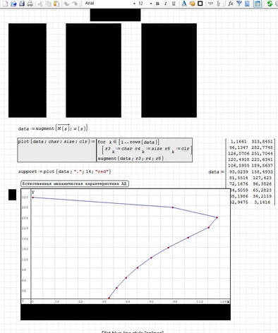

#8 Опубликовано: 27.02.2023 08:47:08
If I have a graph (attached file), then how do I mark the points along which it passes?
As in the attached.
Instead of re-scaling the same graph, plots all new graph on the same plot.
You will scale to accommodate for the larger graph.
AD Plot Points.sm (104,39 КиБ) скачан 1323 раз(а).

#10 Опубликовано: 27.02.2023 13:38:10
Is there any simple way to add the pass points and autoscale a graph?
Some Smath versions decided that opening in other versions will be black.
1. Open this document
2. If black, select by groups, click on background white
3. Make the all document as per 2. directive
4. at this point, you have recovered my original
5. Plot points and more advanced.
AD Plot Points TopUser2000.sm (87,24 КиБ) скачан 1244 раз(а).

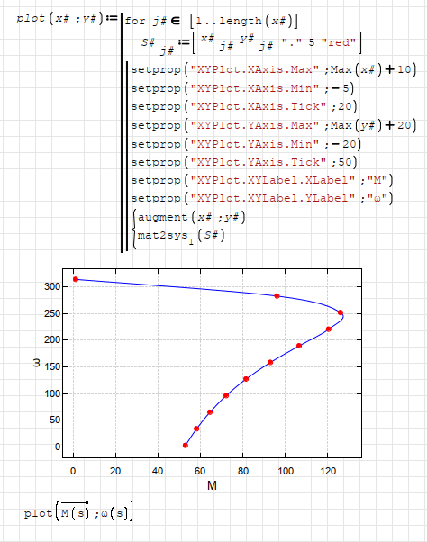

#11 Опубликовано: 27.02.2023 13:57:37
You can use this, XYPlot region is suitable.
One custom function to plot everything.
It also autoscale the graph.
AD.sm (28,23 КиБ) скачан 1214 раз(а).

По точкам нужно просто посмотреть примеры использования графиков.
setprop() - функция устанавливает свойство компонента. Возвращает 1, если свойство найдено и успешно установлено, иначе 0.
Она ищет компоненты на всех листах с указанным именем и меняет указанное свойство. Набор доступных для изменения свойств ограничен.
Точки также можно включить в свойствах кривой. ПКМ на компоненте и выбрать настройки, далее зайти в свойства кривой и там выбрать тип маркеров вместо пустого.
В компоненте XYPlot нет автомасштаба, поэтому пока так.
