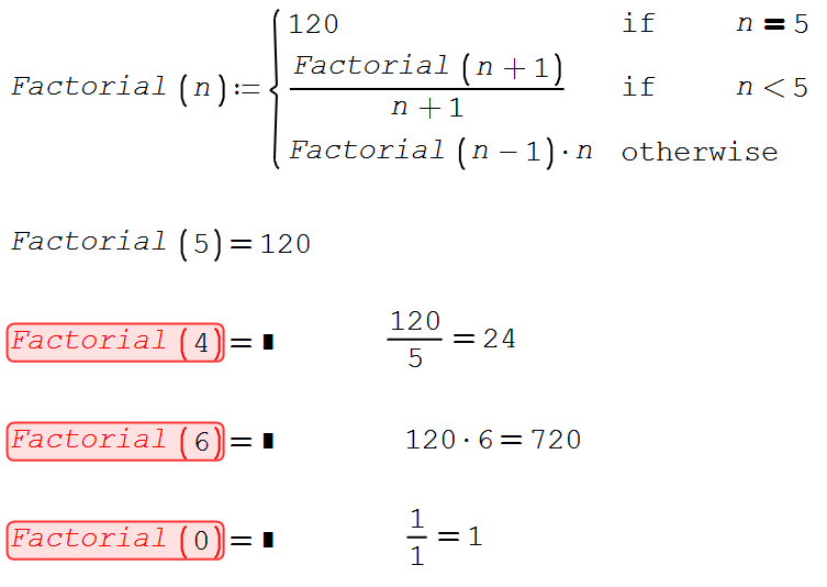

#1 Posted: 8/24/2024 12:02:53 PM
Valery Ochkov
Valery Ochkov

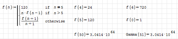

Hi Valery. Just use line:
Valery Ochkov 8/24/2024 2:15:00 PM, sergio 8/25/2024 1:07:00 AM

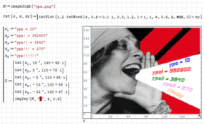

Hi. This other too.
img2xy ypa.pdf (423.85 KiB) downloaded 882 time(s).
img2xy ypa.sm (353.82 KiB) downloaded 1604 time(s).
Valery Ochkov 8/25/2024 6:17:00 PM

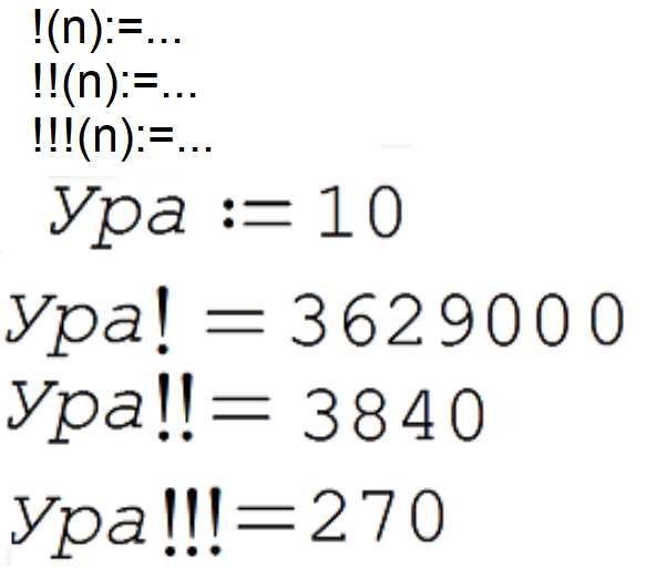

Thanks, Alvaro!
But I think about a postfix operator.
Alvaro 8/26/2024 7:20:00 PM
#8 Posted: 8/26/2024 7:26:48 PM
Oh. I see. What an epic fail trying to interpret an "it" (From "Create it in SMath! " ). I had seen that work at a Soviet art exhibition at the Museo de Bellas Artes in Mexico City, and it is without a doubt very representative of an entire movement.

https://en.smath.com/forum/yaf_postst25358_Pre--Post--and-Infix-Operators.aspx
