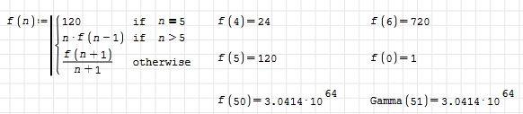

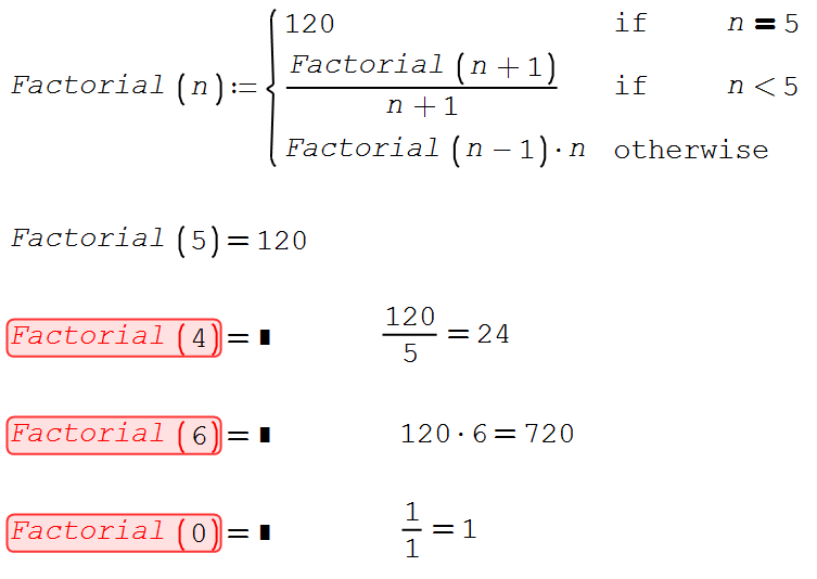

Hi Valery. Just use line:
Valery Ochkov 24.08.2024 14:15:00, sergio 25.08.2024 01:07:00

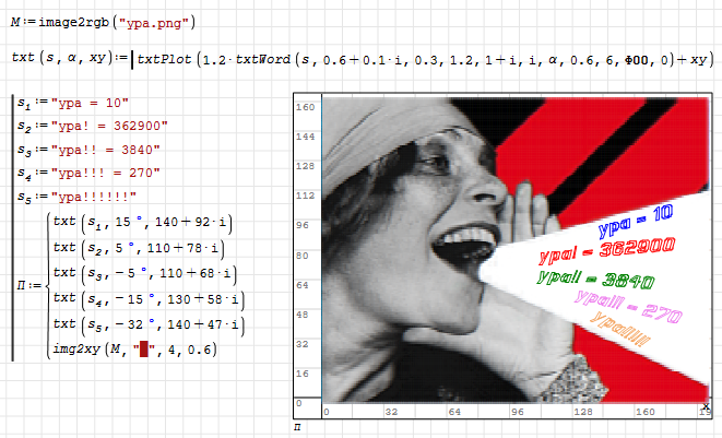

Hi. This other too.
img2xy ypa.pdf (423,85 КиБ) скачан 881 раз(а).
img2xy ypa.sm (353,82 КиБ) скачан 1603 раз(а).
Valery Ochkov 25.08.2024 18:17:00

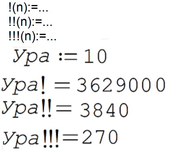

#7 Опубликовано: 25.08.2024 18:18:38
Valery Ochkov
Valery Ochkov
Thanks, Alvaro!
But I think about a postfix operator.
Alvaro 26.08.2024 19:20:00
