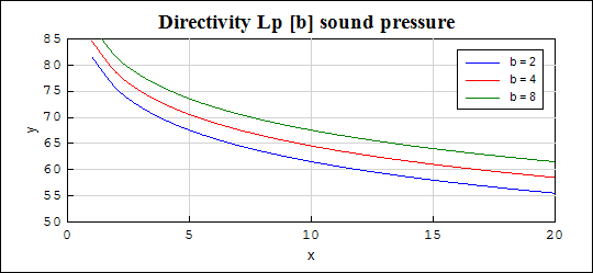

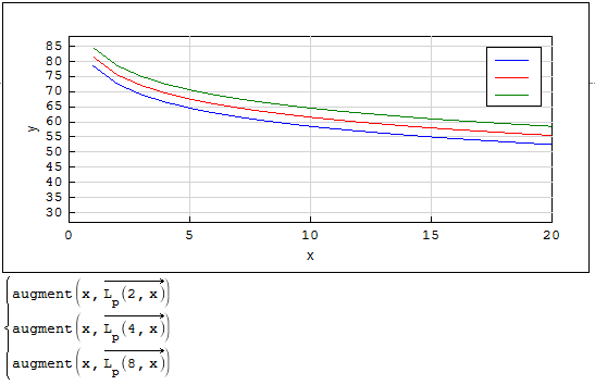

#1 Posted: 4/10/2018 11:40:58 AM
I think I need a program loop to get the graph to show up correctly. Suggestions?
Quick Sound Loss.smz (132.15 KiB) downloaded 1156 time(s).
#2 Posted: 4/10/2018 11:56:29 AM
WroteI think I need a program loop to get the graph to show up correctly.Suggestions?
"Why does log10 look different ?"
because you have two different formulas, thus two different results

#4 Posted: 4/10/2018 2:31:49 PM
Strict math seems correct to me; let's compare the values for different directivity factors at ssame distance.
we have:
to simplify things we can get rid of the absolute value; in your example all numbers are above 1, plus logarithms' arguments are <= 8 in numerator and >= 12 in denominator (4*pi*distance_greater_than_1), thus:
at same distance, log10(f(x)) is the same for every directivity factor Q
Lw(Q,1.5) loses -3dB when you double Q, but at the same time the absolute value term adds +3B -> so why values are so close (and functions overlapped in the plot)
In fact, if you go further, you can do the same for Lw:
and decimal shown in the workshet are only because different decimal places shown in the results
we have:
log(a/b)=log(a)-log(b)
|10*log10(a/b)| = 10*(log10(b)-log10(a)) = 10*(log10(f(x))-log10(Q)) = 10*log10(f(x))-10*log10(Q)
10*log10(f(x))-10*log10(Q) = const-10*log10(Q)
10*log10(2)=3, 10*log10(4)=6, 10*log10(8)=9 (approx)
Lp(Q,x)=Lw(Q,1.5)-|10*log10(a/b)|=Lw(Q,1.5)-const+10*log10(Q)
Lw(Q,dist) = Ltot+|10*log10(Q/f(dist))| = Ltot+10*log10(f(dist))-10*log10(Q) = const2-10*log10(Q)
Lp(Q,x) = Lw(Q,1.5)-const1+10*log10(Q) = const2-10*log10(Q)-const1+10*log10(Q) = const2-const1 = constant
#5 Posted: 4/10/2018 2:50:48 PM
What might be wrong...
You have sound pressure measured by the vendor -> You have to calculate the power level for the distance and directivity condition of the vendor
Then you have the sound power level of your source... it's a constant! Use this value to estimate the sound power at various distances for various directivity conditions!
Quick Sound Loss - rev.1.sm (134.93 KiB) downloaded 1165 time(s).

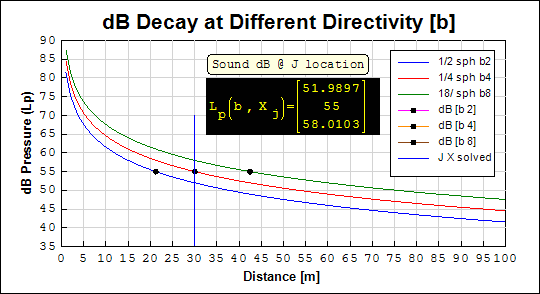

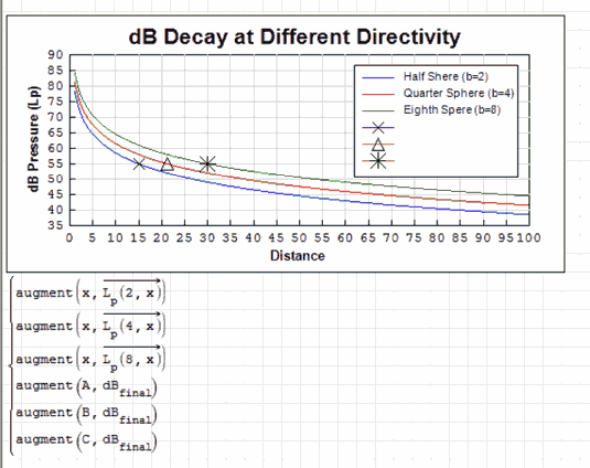

#8 Posted: 4/10/2018 5:41:23 PM
Funny ...
OK, here I am as I had done most of the items that Davide and Jean added. Now I would like to add a "dot" or a vertical line where the dB.final is. Please use this sheet
Quick Sound Loss.smz (135.1 KiB) downloaded 1157 time(s).
Jean, I did not see where you used a spline
All should I be using "cinterp" to place the "dot?
#9 Posted: 4/10/2018 7:30:35 PM
Something like this?
Quick Sound Loss - rev.1.sm (134.93 KiB) downloaded 1115 time(s).
Carlos
Carlos
#10 Posted: 4/10/2018 7:43:06 PM
WroteJean, I did not see where you used a spline
1. spline is for line style ... line/spline.
2. what that gyzma #,#,#,,,does in maths ?
3. X_Y plot does not support " in your plot suggestion
4. X_Y is for final/final/final ... project
once done, if you rework something above=> it will freak the plot
X_Y plot has slightly pregnant memory. Doctored in red .
Quick Sound Loss (3).sm (140.83 KiB) downloaded 1361 time(s).
#11 Posted: 4/10/2018 8:45:59 PM
#12 Posted: 4/10/2018 9:18:04 PM
Ok, This is the right file
Quick Sound Loss (1)_r1.sm (140.03 KiB) downloaded 1404 time(s).
Carlos
Carlos

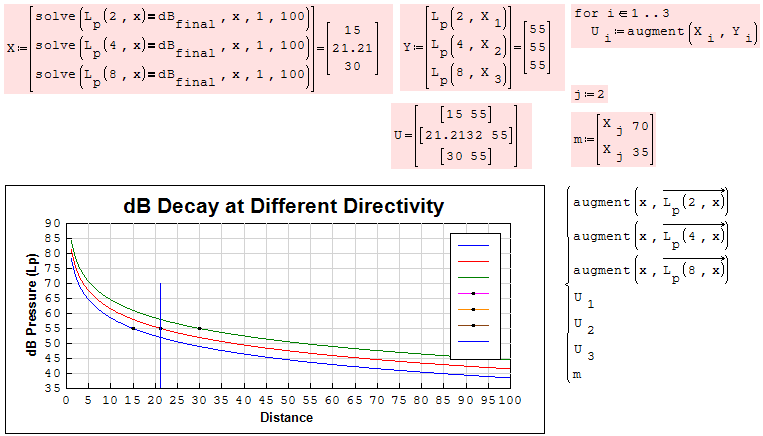

#15 Posted: 4/13/2018 2:23:09 AM
Well, Here we go again ...
I found a quirk. Depending on values dB initial values, neither solve nor FindRoot is functional. I was plugging in values by hand without seeing an issue. I tried a "higher" dB set of values (86 vs 75) for equipment and the calculation *zap*
Quick Sound Loss.smz (168.74 KiB) downloaded 1189 time(s).
Also, the X-Y plot legend information *ZAP*
#16 Posted: 4/13/2018 8:55:34 AM
WroteWell, Here we go again ...
I found a quirk.Depending on values dB initial values, neither solve nor FindRoot is functional.I was plugging in values by hand without seeing an issue.I tried a "higher" dB set of values (86 vs 75) for equipment and the calculation *zap*
That one was Doctored and you don't use the Doctored version.
Explained before, if above X_Y something is Doctored, zap.
Quick Sound Loss (4) Doctored 20180413.sm (167.01 KiB) downloaded 1158 time(s).

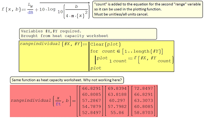

#19 Posted: 1/25/2021 8:16:25 PM
Revisiting this old calc with SMath newer features and some function definitions.
Sound Loss (Quick).sm (476.36 KiB) downloaded 1256 time(s).
Thanks for the help.
- No longer works if I redefine the logarithmic sum with vectorize
- I cannot get the "heat capacity function" to work for ploting
#20 Posted: 1/25/2021 9:34:45 PM
Hi. Some notes, but I'm not sure if this solve all of the issues:
1. Use count inside rangeindividual, but not outside. You use it in f(x, b ), and guess that could be problematic.
2. After that, you divide x by 'm in f and x by feet in rangeindividual, choose only one.
3. Maybe here don't affect, but if rangeindividual have not f(#,#) as parameter, define f before rangeindividual, you know, just in case.
