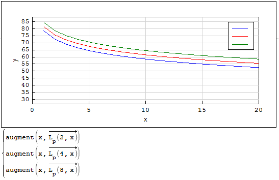

I think I need a program loop to get the graph to show up correctly. Suggestions?
Quick Sound Loss.smz (132,15 КиБ) скачан 1156 раз(а).
#2 Опубликовано: 10.04.2018 11:56:29
I think I need a program loop to get the graph to show up correctly.Suggestions?
"Why does log10 look different ?"
because you have two different formulas, thus two different results

#5 Опубликовано: 10.04.2018 14:50:48
What might be wrong...
You have sound pressure measured by the vendor -> You have to calculate the power level for the distance and directivity condition of the vendor
Then you have the sound power level of your source... it's a constant! Use this value to estimate the sound power at various distances for various directivity conditions!
Quick Sound Loss - rev.1.sm (134,93 КиБ) скачан 1165 раз(а).

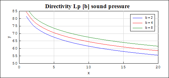

#7 Опубликовано: 10.04.2018 16:42:50
Jean,
The second equation is off/not evaluated.Graphically log to base x and log10 display differently.Question is about graph though
Few more things you can do as real project.
Line style "splines" is a bit smoother in the low region.
Quick Sound Loss - rev.2.sm (134,54 КиБ) скачан 1147 раз(а).

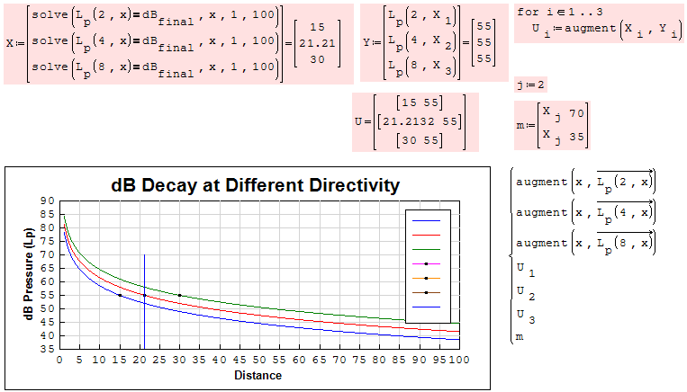

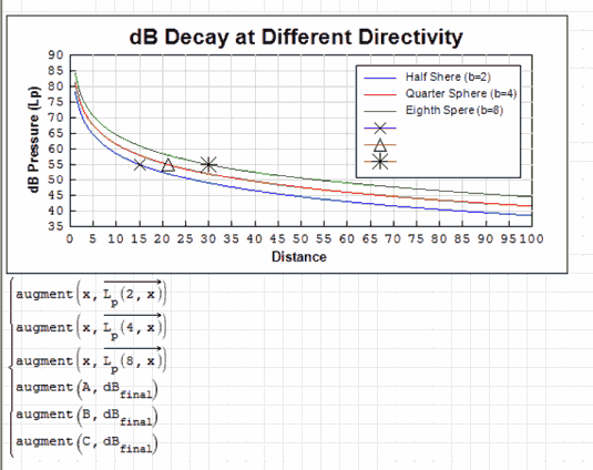

OK, here I am as I had done most of the items that Davide and Jean added. Now I would like to add a "dot" or a vertical line where the dB.final is. Please use this sheet
Quick Sound Loss.smz (135,1 КиБ) скачан 1157 раз(а).
Jean, I did not see where you used a spline
All should I be using "cinterp" to place the "dot?

Something like this?
Quick Sound Loss - rev.1.sm (134,93 КиБ) скачан 1115 раз(а).

#10 Опубликовано: 10.04.2018 19:43:06
1. spline is for line style ... line/spline.
2. what that gyzma #,#,#,,,does in maths ?
3. X_Y plot does not support " in your plot suggestion
4. X_Y is for final/final/final ... project
once done, if you rework something above=> it will freak the plot
X_Y plot has slightly pregnant memory. Doctored in red .
Quick Sound Loss (3).sm (140,83 КиБ) скачан 1361 раз(а).

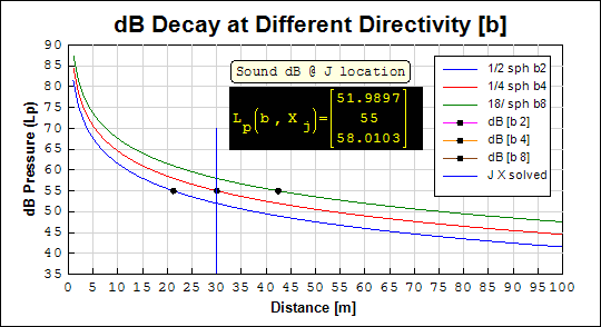

#11 Опубликовано: 10.04.2018 20:45:59
Ruben Sidranski
Ruben Sidranski
Carlos,
I think you attached the wrong file. Yes, that is what I was looking for.

#12 Опубликовано: 10.04.2018 21:18:04
CBG
CBG
Ok, This is the right file
Quick Sound Loss (1)_r1.sm (140,03 КиБ) скачан 1404 раз(а).
Carlos

Found the issue(s). See revamped file. Still having issues in that X-Y plot Labels for the legend *zap*Quick Sound Loss.smz (142,28 КиБ) скачан 1879 раз(а).
Edit: Two bugs
  1. X-Y Plot. If functions crash, *Zap* to the legend titles. All other titles OK. Legend is empty due to laziness after last 5 crashes
  2. solve(4) did not like trying to cancel units in the denominator of the final function (#dist). As I was adding units to x:0-100 FT and dividing the units meters in the function, the function crashed in the solve block (Just the function, with all values plugged in except for x = vector, so it's a solve(4) issue).
This is one of those sheets where UNITS are huge! The equations are all based off of SI/metric references. Major issue
There is additional documentation and function definition updates. Sanity check the graph x scale (adjusted for feet since I'm in the US). Should be good now
#18 Опубликовано: 13.04.2018 11:38:07
Found the issue.I'll post revamp file.Still having issues in that X-Y plot Labels for the legend *zap*
Clik on "list", edit "series name".

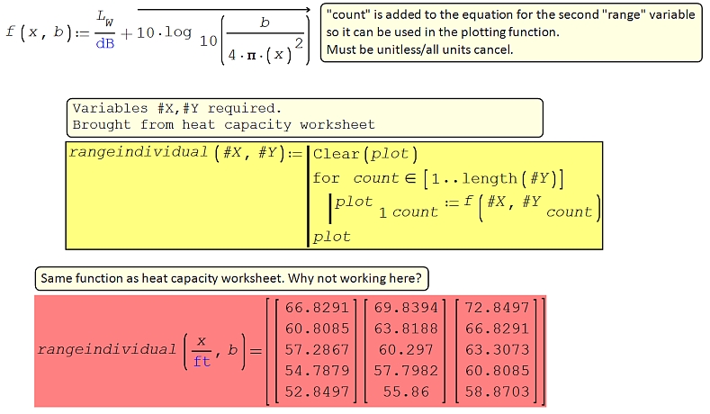

Revisiting this old calc with SMath newer features and some function definitions.
  1. No longer works if I redefine the logarithmic sum with vectorize
  2. I cannot get the "heat capacity function" to work for ploting
Sound Loss (Quick).sm (476,36 КиБ) скачан 1256 раз(а).
Thanks for the help.
#20 Опубликовано: 25.01.2021 21:34:45
Hi. Some notes, but I'm not sure if this solve all of the issues:
1. Use count inside rangeindividual, but not outside. You use it in f(x, b ), and guess that could be problematic.
2. After that, you divide x by 'm in f and x by feet in rangeindividual, choose only one.
3. Maybe here don't affect, but if rangeindividual have not f(#,#) as parameter, define f before rangeindividual, you know, just in case.
