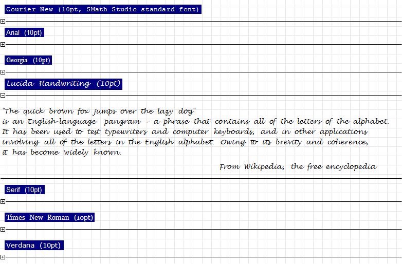

A sheet containing some text area with various font-families to use in your own scripts (copy from this sheet, paste in your sheets and modify the area).
best regards,
w3b5urf3r

#13 Posted: 3/1/2014 11:55:30 AM
1,443 likes in 2,935 posts.
Uploaded in the Extensions Manager (Examples)
Best regards,
Davide

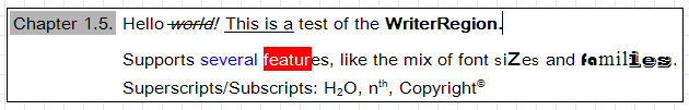

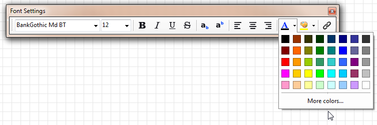

BTW working to the SectionRegions plugin, I'm making an easy-to-use WriterRegion, and I've also produced a (back-end) customizable toolstrip to drive the text settings (as for now, the toolbar is just a toy).
ioan92 9/26/2014 2:17:00 PM
#18 Posted: 10/8/2014 12:37:01 PM
A screenshot... will be relased as WriterRegion (when will be stable and complete enough).
6 users liked this post
hitaisin 1/4/2015 4:37:00 AM, Radovan Omorjan 10/8/2014 1:54:00 PM, Вячеслав Мезенцев 10/8/2014 1:12:00 PM, ioan92 10/8/2014 3:28:00 PM, Peter 10/9/2014 12:07:00 AM, Andrey Ivashov 10/11/2014 9:11:00 AM
