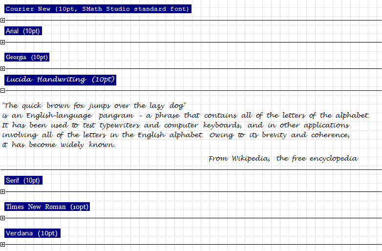

A sheet containing some text area with various font-families to use in your own scripts (copy from this sheet, paste in your sheets and modify the area).
best regards,
w3b5urf3r

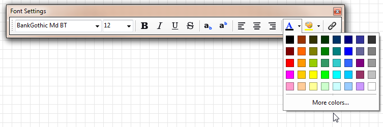

BTW working to the SectionRegions plugin, I'm making an easy-to-use WriterRegion, and I've also produced a (back-end) customizable toolstrip to drive the text settings (as for now, the toolbar is just a toy).

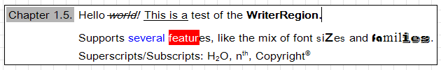

A screenshot... will be relased as WriterRegion (when will be stable and complete enough).
