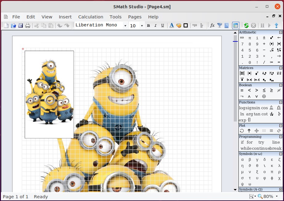

If your Insert > Picture > From File, function don't work properly on Linux.
When I add picture file it shows in SMath but when I save-close-reopen it disappears.
Region is there but picture is gone. In a text editor, base64 data is mostly missing too.
Most of image data is neglected and not written.
I have checked this with another user and another machine of mine.
Image Region don't have this issue.

Yes, insert picture on windows works correct on Linux does not.
Clipboard paste also doesn't work on Linux.
Only image region function properly.

The clipboard problem is inherent to Linux rather than an SMath problem.
I predict that the bug overlord is reporting (broken "Insert Image From File" in Linux) is fixable though. It would be better to have a native SMath way to do this than having to rely on an external tool like Xclip or the one I posted.

Yes, in Ubuntu 20.04, it behaves the same thing.
Lost the image when I open, blank picture region.
Regards, Waluyo

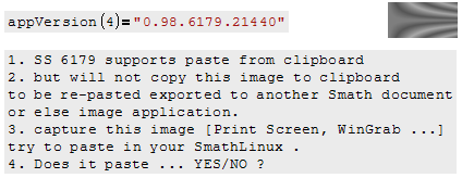

Long time ago, I mentioned Smath didn't support copy to clipboard
Was it SS 5346 or SS 6179 ?
Apparently it was fixed. Whatever, it has to be clear that the problem
is SmathLinux from Linux not supporting clipboard paste.
Venturi.sm (5.51 KiB) downloaded 1296 time(s).

1 - Clipboard paste is a bug on Linux not related specific to SMath.
You can't simply paste if clipboard is an image on Linux. You have to tell OS during paste that clipboard is an image file.
2 - Picture insert is another bug on Linux but related to SMath.
When you insert picture, image data is half written to file in SMath file. This is SMath's bug on Linux.
They are not related, they are different.

Here let me demonstrate it with a video for you to explain it more detailed.
Linux Picture Insert Bug Video
Somehow SMath is not getting full picture data, this is not Linux bug. This is a SMath bug on Linux.

  • Loading splash screen layout fixed:
  • Work with images fixed (save/open files with images, image regions copy/paste, background images)
  • Dark OS theme supported now (not all toolbox icons are vectorized yet - this is test version);

Hi, it's working for me. Thanks!
#15 Posted: 10/23/2020 11:34:58 AM
598 likes in 1,380 posts.
All is good here, dragging picture from file managers works too.
Thank you Andrey for quick response.

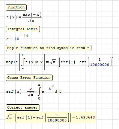

By the way, the calculation you have sent is a Gauss Error Function. erf()
Apparently SMath don't have it yet but you can implement it easily.
Maybe Andrey will add erf() someday, who knows.
I have calculated this on windows. Maple don't work on linux, yet.

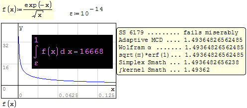

Thanks for checking latest SS
Erf(x) is built-in since at least SS 5346 erf(1) from f(x) menu
erf(x) is a monkey business approximation [Mathematica]
But works well in Smath, presumably all versions.
Maths erf(x).sm (32.6 KiB) downloaded 1378 time(s).

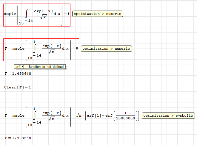

erf() is not built-in to SMath, I have checked.
It is a function of Statistical Tools plugin.
That plugin was not installed on my setup.
I have installed the Statistical Tools plugin to get erf().
It works but still gives "erf() function is not defined" error with maple.
Numeric optimization is causing this when I try to get a numeric result.
However it is calculating the expression and giving the result assigned to a variable, even with numeric optimization.
No issues with symbolic optimization I guess.
Odd behavior.
