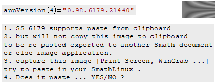

Let it go step by step, this first step
Can you in your latest SS copy few math regions and paste in IrfanView.
SS 6179 can't ... Mathcad 8, 11 can for unlimited number of regions ... pages.
If you haven't experimented Venturi as described, sorry but end of it.

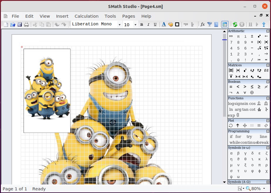

Jean, our subject is not copy from SMath paste into Irfanview, MS Paint, etc.
That is not the issue of this subject, this is about Linux > Insert > Picture > From File bug.
Here let me demonstrate it with a video for you to explain it more detailed.
Linux Picture Insert Bug Video
Somehow SMath is not getting full picture data, this is not Linux bug. This is a SMath bug on Linux.
PS: For your question (not subject of the bug), under windows, answer is YES.
You can copy the venturi image or whole canvas and paste it to Irfanview, MSPaint, Photoshop, Paint.Net, Word, etc. Wherever you want.
Just update your SMath to latest version for full features and please please I beg you, stop torturing us with your way outdated SMath build.

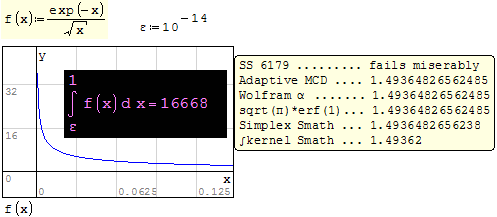

Not long ago, SS 7959 integration had to be doctored.
Please try that one for the benefit of the Community.
#17 Опубликовано: 23.10.2020 12:15:49
Your response is not related with now fixed picture insert bug on linux.
However, result is same in build 7579 as 6179.
Even if the results are same and wrong I would use 7579.
New one has more features. And other bugs are fixed as well.

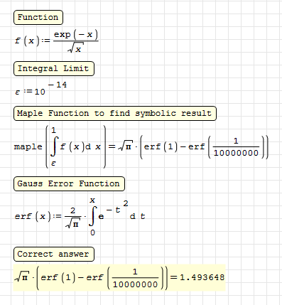

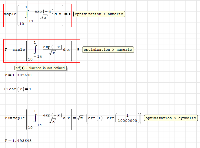

By the way, the calculation you have sent is a Gauss Error Function. erf()
Apparently SMath don't have it yet but you can implement it easily.
Maybe Andrey will add erf() someday, who knows.
I have calculated this on windows. Maple don't work on linux, yet.
#18 Опубликовано: 23.10.2020 21:19:04
Thanks for checking latest SS
Erf(x) is built-in since at least SS 5346 erf(1) from f(x) menu
erf(x) is a monkey business approximation [Mathematica]
But works well in Smath, presumably all versions.
Maths erf(x).sm (32,6 КиБ) скачан 1378 раз(а).
#19 Опубликовано: 23.10.2020 23:37:53
erf() is not built-in to SMath, I have checked.
It is a function of Statistical Tools plugin.
That plugin was not installed on my setup.
I have installed the Statistical Tools plugin to get erf().
It works but still gives "erf() function is not defined" error with maple.
Numeric optimization is causing this when I try to get a numeric result.
However it is calculating the expression and giving the result assigned to a variable, even with numeric optimization.
No issues with symbolic optimization I guess.
Odd behavior.
