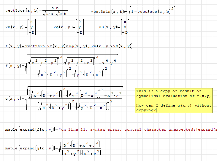

Simple question: how to assign a symbol to the result of symbolical evaluation? Sorry have not found the answer.
E.g. I have some function f(x).
I want to assign another function g(x) to the result of symbolical evaluation of df(x)/dx.
If I assign g(x) to df(x)/dx and make symbolical evaluation, I get correct result, but g(x) is still assigned to df(x)/dx.
Of course, I can symbolically evaluate df(x)/dx and copy the result to the definition of g(x), but then g(x) will not change if the function f(x) changes.

testassign.sm (14.53 KiB) downloaded 1115 time(s).
Sorry, have not found the answer. Attached is a sample with two functions f(x,y) and g(x,y).
In the sample I have just copied the result of symbolical evaluation of f(x,y) to g(x,y). How to perform this assignment directly? I need g(x,y) to be updated if input vectors change.
Easy to see that symbolical evaluation does not change f(x,y). Maple can undestand g(x,y) but not f(x,y).

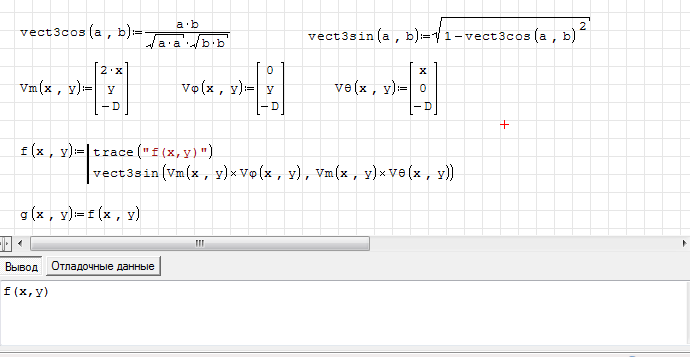

#4 Posted: 5/3/2017 1:30:19 PM
... just assign like this g(x,y):=f(x,y)
shown in red Smath 6179 attached.
Does it work for you ?
testassign.sm (16.83 KiB) downloaded 1114 time(s).

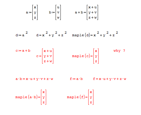

maple() function doesn't understand smath cross product symbol. It is not supported in the current version.
Hello Jean,
no, it does not work. It assigns original f(x,y) to g(x,y) and not symbolically evaluated, see blue fields in attachment.

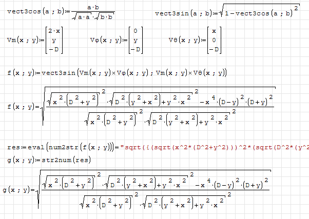

This works.
testassign_Kr.sm (17.97 KiB) downloaded 1075 time(s).

avanturist 5/5/2017 2:48:00 PM
#8 Posted: 5/3/2017 10:26:26 PM
The blue is just maple()simplify(...)

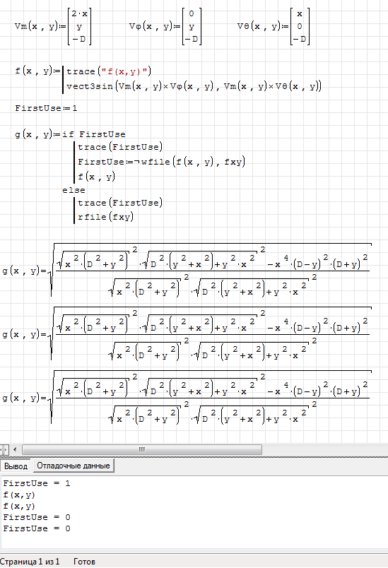

#11 Posted: 5/4/2017 12:28:45 PM
As I understood, there is no regular way in SMath to access already existing result of symbolic evaluation. The solutions are tricks to export the result to string/file and to import it back.
There is no trick spool to file the immediate maple,
no more trick spool back wherever you want.
Maple series.sm (23.83 KiB) downloaded 1120 time(s).

#13 Posted: 5/4/2017 2:34:02 PM
... as far as I understand: you request for TWO cross-product.
In fact, there are more that you can collect/spool to file.
testassign_Kr.sm (11.95 KiB) downloaded 1070 time(s).

I might be wrong here, but I think the question is about something like this regarding maple.
If you can not reproduce this, there might be something wrong with my SMath.
Regadrs,
#20 Posted: 5/6/2017 6:32:36 AM
1,555 likes in 1,867 posts.
This is bug in maple() function. Not all operations are performed correctly during the conversion.
