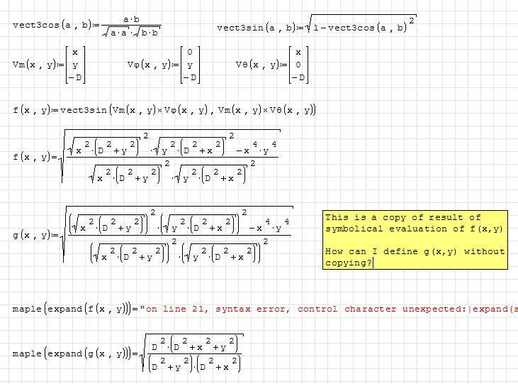

Simple question: how to assign a symbol to the result of symbolical evaluation? Sorry have not found the answer.
E.g. I have some function f(x).
I want to assign another function g(x) to the result of symbolical evaluation of df(x)/dx.
If I assign g(x) to df(x)/dx and make symbolical evaluation, I get correct result, but g(x) is still assigned to df(x)/dx.
Of course, I can symbolically evaluate df(x)/dx and copy the result to the definition of g(x), but then g(x) will not change if the function f(x) changes.

Sorry, have not found the answer. Attached is a sample with two functions f(x,y) and g(x,y).
In the sample I have just copied the result of symbolical evaluation of f(x,y) to g(x,y). How to perform this assignment directly? I need g(x,y) to be updated if input vectors change.
Easy to see that symbolical evaluation does not change f(x,y). Maple can undestand g(x,y) but not f(x,y).

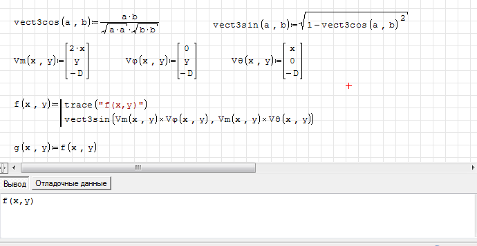

... just assign like this g(x,y):=f(x,y)
shown in red Smath 6179 attached.
Does it work for you ?
Hello Jean,
no, it does not work. It assigns original f(x,y) to g(x,y) and not symbolically evaluated, see blue fields in attachment.

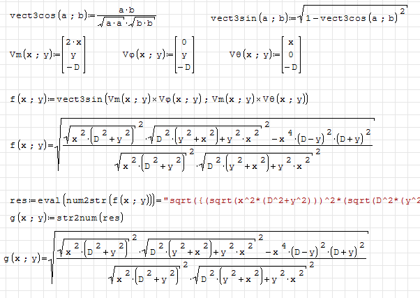

This works.
testassign_Kr.sm (17,97 КиБ) скачан 1075 раз(а).

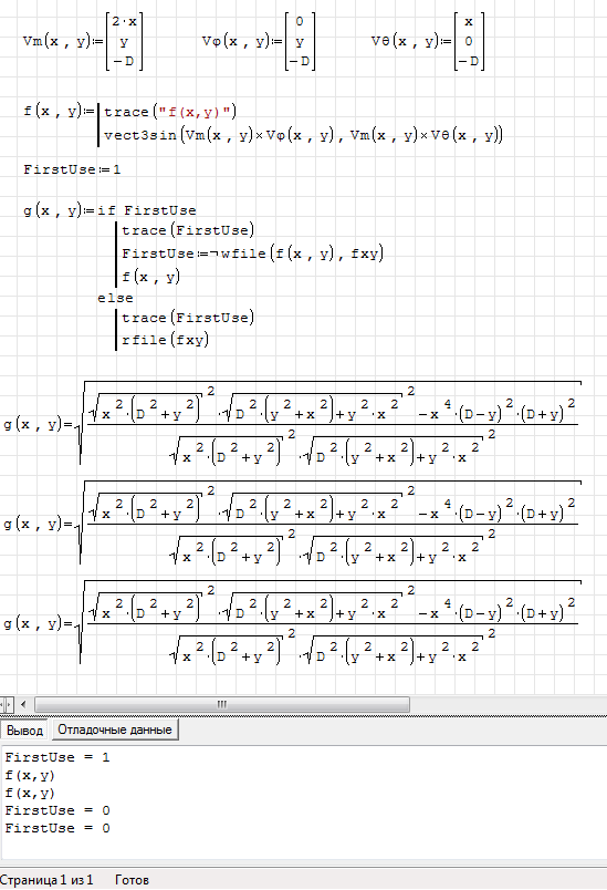

#9 Опубликовано: 04.05.2017 01:34:25
Something like this?
#10 Опубликовано: 04.05.2017 11:08:56

Thanks to Martin and Viacheslav for working solutions!
As I understood, there is no regular way in SMath to access already existing result of symbolic evaluation. The solutions are tricks to export the result to string/file and to import it back.

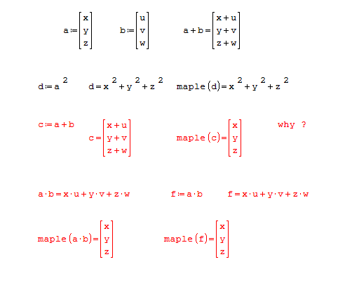

I might be wrong here, but I think the question is about something like this regarding maple.
If you can not reproduce this, there might be something wrong with my SMath.
Regadrs,

This is bug in maple() function. Not all operations are performed correctly during the conversion.
