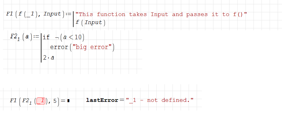

I am having some strange issues with cases/if statements that contain variables in the condition in addition to error() function in the result.
The issue only arises when the if/cases statements are in a function that is passed into another function. See attached.
Any thoughts?
variablesInConditions.sm (14.62 KiB) downloaded 1574 time(s).
variablesInConditions.pdf (88.21 KiB) downloaded 831 time(s).

#3 Posted: 6/21/2023 10:28:04 AM
Arie
Arie
94 likes in 285 posts.
This is certainly a workaround. Something I could do and perform error handling at the next level.
I'm more curious is this is an actual bug or if I'm doing something incorrectly.

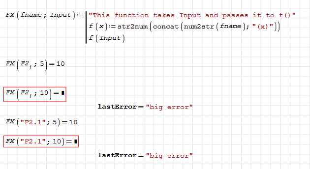

#8 Posted: 6/23/2023 10:33:15 AM
Hi, sorry the late answer!
hanks for the explanation. I think I understand why cases(...) will not work. But I still receive a strange error when using if(...). Is this also expected?
Yes, altough I'm not sure if could be improved by Andrey somehow.
With some slight modifications on the names, you can see more clearly that the error is generated on the F1(2) preprocessing. Here x is passed as input to the first argument and if() fires the error.
The only alternative that comes to my mind right now is the one below. You have to pass the function name rather than the function itself.
It is a workaround, and if you pass it as a variable, the variable itself must be not defined.
variablesInConditions_alt1.sm (11.58 KiB) downloaded 1522 time(s).
(The attachment has a more complicated function just to make the string input independant from localization settings)
Arie 6/23/2023 2:29:00 PM

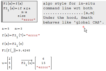

#9 Posted: 6/23/2023 2:03:50 PM
More instances of if/otherwise failed in program.
if/otherwise does not belong to the Smath kernel.

Thanks Davide!
This workaround will suffice for me.
Davide Carpi 6/25/2023 7:10:00 AM
