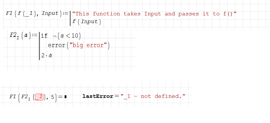

I am having some strange issues with cases/if statements that contain variables in the condition in addition to error() function in the result.
The issue only arises when the if/cases statements are in a function that is passed into another function. See attached.
Any thoughts?
variablesInConditions.sm (14,62 КиБ) скачан 1574 раз(а).
variablesInConditions.pdf (88,21 КиБ) скачан 831 раз(а).
This is certainly a workaround. Something I could do and perform error handling at the next level.
I'm more curious is this is an actual bug or if I'm doing something incorrectly.

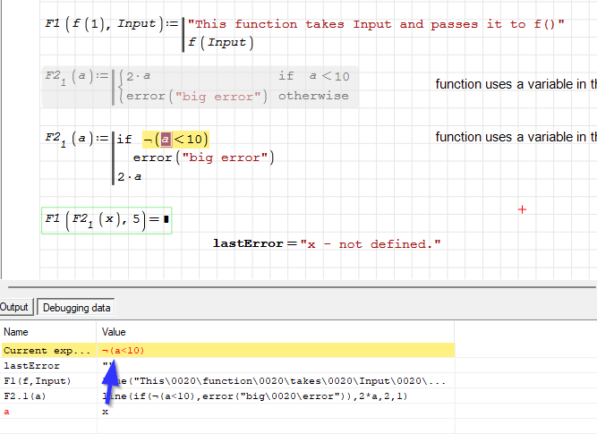

Hello, this is expected. By design because framework constraints, not by will, but it is the only way to have the function working in some contexts like inside integrals and such.
In case of numerical evaluation of the conditions, like in the if(...) function, the single cases are "sealed" from evalution up to when the conditions are actually evaluable. In cases(...) everything is always exposed to evaluation (and that's why you shouldn't use assignments inside the single cases). Hence, since error() is evaluated, it throws the error message.

With some slight modifications on the names, you can see more clearly that the error is generated on the F1(2) preprocessing. Here x is passed as input to the first argument and if() fires the error.

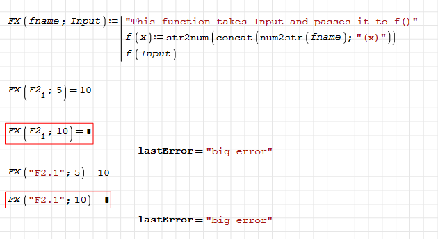

The only alternative that comes to my mind right now is the one below. You have to pass the function name rather than the function itself.
It is a workaround, and if you pass it as a variable, the variable itself must be not defined.
variablesInConditions_alt1.sm (11,58 КиБ) скачан 1522 раз(а).
(The attachment has a more complicated function just to make the string input independant from localization settings)

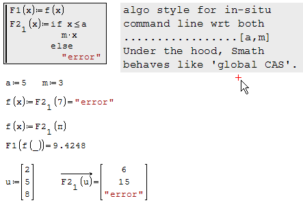

More instances of if/otherwise failed in program.
if/otherwise does not belong to the Smath kernel.
