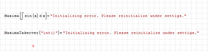

Hello.
Maxima does not work in my SMath. What is wrong?
First use of Maxima function asks me for a path to maxima.bat, but there does not follow any dialog for to find the file...
Any maxima function gets an error. See images.
Thanks for answer
Regards Olik

Same problem here. I have used maxima plugin for a while and in last weeks suddenly it failed and the "initializing error" end "cannot find maxima.bat" errors appeared. Maybe [USERLINK]Mkraska[/USERLINK] can help with this issue.
