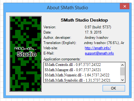

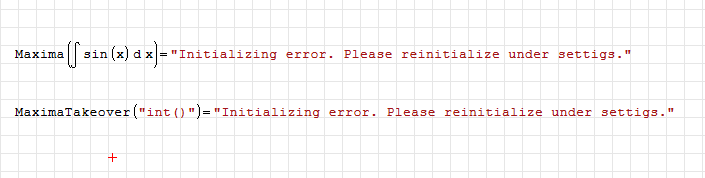

Hello.
Maxima does not work in my SMath. What is wrong?
First use of Maxima function asks me for a path to maxima.bat, but there does not follow any dialog for to find the file...
Any maxima function gets an error. See images.
Thanks for answer
Regards Olik

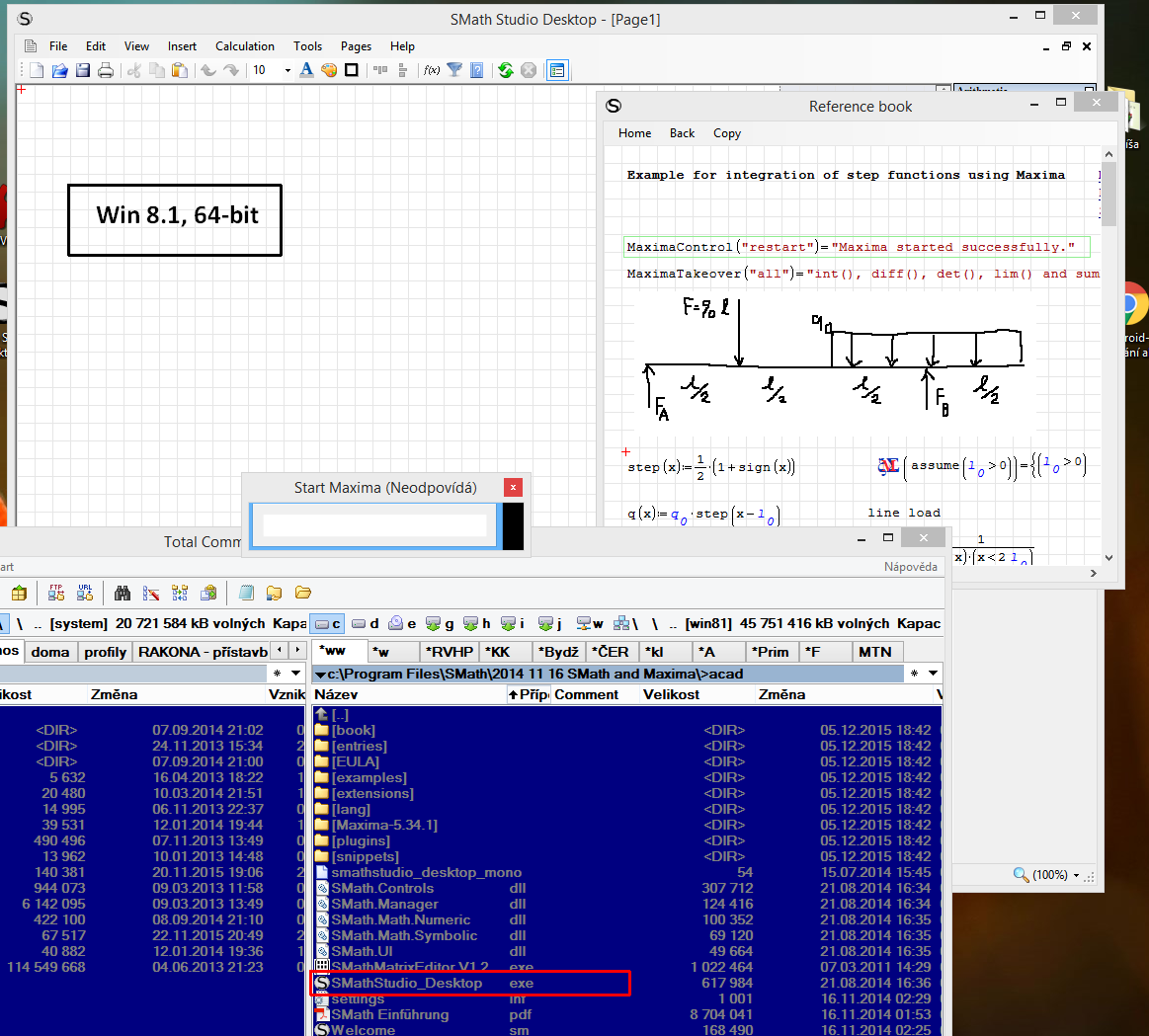

Hello.
I tried to run portable with maxima on w7, w8 -- collapsed
and on w xp -- I could Takeover, but I could not evaluate int() function.
Sorry. I solved my problem using maple() function. It is not so nice ...
regards, Olik
