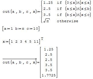

#8 Posted: 11/10/2021 11:12:41 AM
NDTM Amarasekera
NDTM Amarasekera
130 likes in 352 posts.
This way also, using lele function. Thank you Jean for the example.
Cheers
