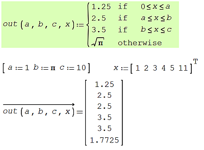

#7 Опубликовано: 10.11.2021 10:33:54
I have several question relative to this image on the page.
Generalize algo style for infinite demands.

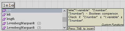

#8 Опубликовано: 10.11.2021 11:12:41
NDTM Amarasekera
NDTM Amarasekera
This way also, using lele function. Thank you Jean for the example.
Cheers
