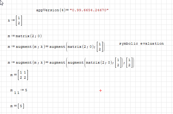

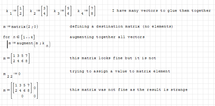

Hi, what am I doing wrong?
m matrix looses it's contents and dimensions after I assigned a single element.
Edit: I found an ugly fix. First I have to create matrix of (2;1) instead (2;0) elements. After all augmenting I have to use submatrix to get rid of first column.

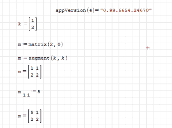

#2 Опубликовано: 22.03.2018 01:04:56
Just like this.
#3 Опубликовано: 22.03.2018 01:49:29

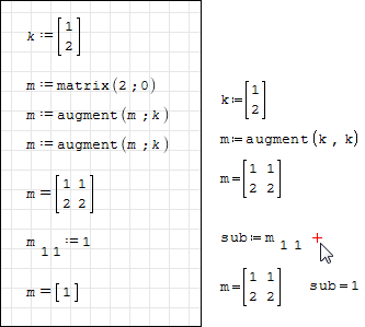

Something like this?
Ass_elem_Matrix.sm (4,52 КиБ) скачан 946 раз(а).

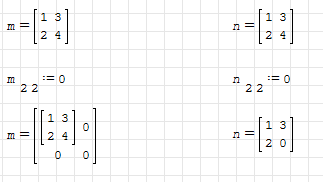

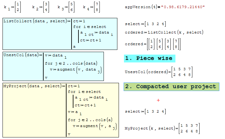

Ok, I probably did not clarify my real needs.
I have some matrices. I just exclude single column from each of them and then I glue them together.
So in my real sheet I never glue the same matrix twice.
Here comes another example where I try to augment some vectors to new matrix.
I have many vectors and they are indexed so I can use program to augment them in a loop.

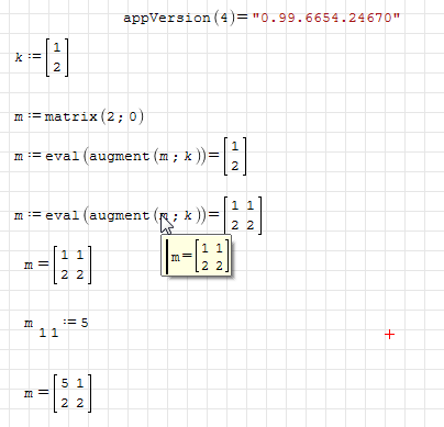

The issue is in the type recognition on the left hand side.
m is a matrix-valued expression rather than a matrix (expression with mat() being the top level object). We had this already with index values being expressions instead of variables.
Thus, the existing m is not recognized as a matrix and therefore not modified but overwritten.
You need to make sure that m is actually stored as matrix, i.e. by applying eval() or by just evaluating numerically (you did symbolically)
I'd prefer SMath to actually check if m evaluates to a matrix and then deciding what to do.
Ass_elem_Matrix_Kr.sm (5,67 КиБ) скачан 893 раз(а).

#6 Опубликовано: 22.03.2018 10:21:30
That will handle your projects more conveniently.
Poland.sm (15,33 КиБ) скачан 907 раз(а).

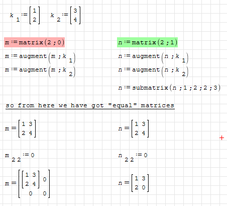

However I think if something looks like matrix it should behave like one. But it is not.
The history of building a matrix affects it
And I treat it as a flaw.
error_matrices_notequal.sm (8,49 КиБ) скачан 921 раз(а).
#8 Опубликовано: 24.03.2018 19:01:20
The flaw is that m is not evaluated before applying the by-element assignment.
you can, however, enforce this by setting the previous two assignments to numeric optimization in the context menu.
This complies to the survival rule "never use symbolic optimization unless you know what you are doing".

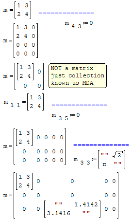

A collection is just a collection.
A matrix supports all matrix operation for concluding a project
Generally, a matrix results from the project itself
Smath works by itself, not from invented not compatible code.
Please be more specific about what you are attempting.

Your original 'm' is a matrix.
Your concluded 'm' is NOT a matrix, simply a collection.
You can't apply any matrix calculation.
Make it a matrix and continue the project.
