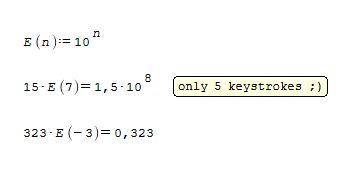

#7 Опубликовано: 25.08.2020 09:40:39
Make your own feature to suit peculiar project.
This notation is native in OriginLab.
Maths e(n).sm (14,94 КиБ) скачан 1079 раз(а).

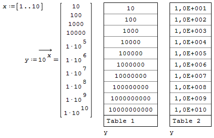

#9 Опубликовано: 27.08.2020 11:49:20
1 333 сообщений из 2 248 понравились пользователям.
I do think it would also be good to consider (optionally) using the common exponent notation for display as it is much more compact in arrays. When an array is full of *10^3 it really blows out the size on the page.
How about the Table region?
sci.sm (13,5 КиБ) скачан 1102 раз(а).

#10 Опубликовано: 28.08.2020 02:31:05
henry crun
henry crun
0 сообщений из 34 понравились пользователям.
That's a useful solution. I see that when scientific is selected, however, that it loses the units.
Is the table plugin part of the closed source, or an open source add on that might be fixable?
[is it: https://smath.info:8443/!/#public/view/head/plugins/TableRegion ?]
However, I would just prefer to have numeric formatting work well in the first place.

#13 Опубликовано: 29.08.2020 10:36:56
It does not lose what's not specified.
Table Scientific.sm (20,56 КиБ) скачан 1135 раз(а).
