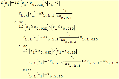

Hey guys,
im trying to plot my function with x-yplot (addon) but it doesnt work. I will be happy if can someone can help me.
i define two functions (with If-clauses) and now I have to put it in x-y-plot.
Thanks for helping
Pfahlsetzungslinie.sm (101,89 КиБ) скачан 1190 раз(а).
#2 Опубликовано: 11.02.2023 09:51:05
I define two functions (with If-clauses) and now I have to put it in x-y-plot.
1. Start by the first red instance ... assign the demand.
2. For the plot Units don't match
3. Check if your incomplete Bolean is OK ... here shown complete.
4. What is mPa

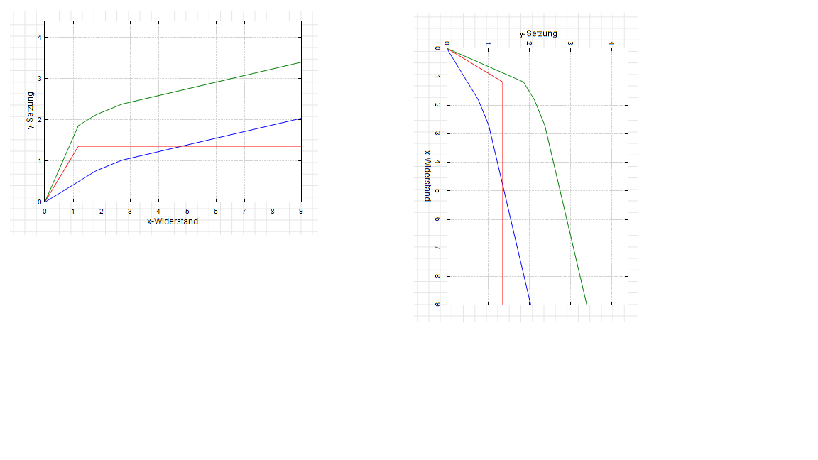

i have 2 more question.
1. is it possible to rotate the graph or function? I wanna switch x and y axis
2. i wanna make the visible spectrum of x and y axis depent on a variable. like X-Axis Max=s1 and Min=s2
//sorry for my bad english
#5 Опубликовано: 11.02.2023 16:44:13
2. I wanna make the visible spectrum of x and y axis depend on a variable. like X-Axis Max=s1 and Min=s2

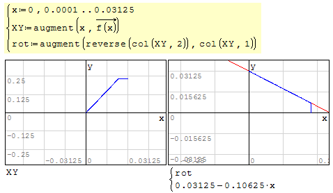

#8 Опубликовано: 12.02.2023 01:43:27
... i have 2 more question.
Hi Beyaz.

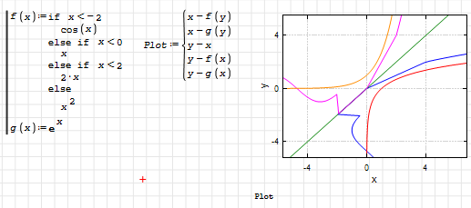

1. Yes. For example you can use this technique over your functions
xy-yx-plot.sm (7,16 КиБ) скачан 1161 раз(а).

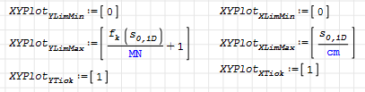

2. Yes. For example you can try to learn about how to use setprop in an XY plot region.

question 2: solved after find this
https://en.smath.com/forum/yaf_postsm57205_X-Y-Plot-Region.aspx
but to rotate the graph like this it didnt work. i tried your suggestions. Pfahlsetzungslinie1.sm (80,01 КиБ) скачан 1185 раз(а).

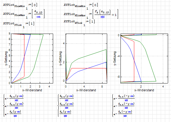

#10 Опубликовано: 12.02.2023 08:47:18
Hi. You need to specify the XYPlot index. This is how to swap axis coordinates, and reverse the y-axis. I reduce the number of points in the XYPlot to 50.
Pfahlsetzungslinie1.sm (87,42 КиБ) скачан 1201 раз(а).

#12 Опубликовано: 12.02.2023 14:23:09
#13 Опубликовано: 13.02.2023 07:13:49

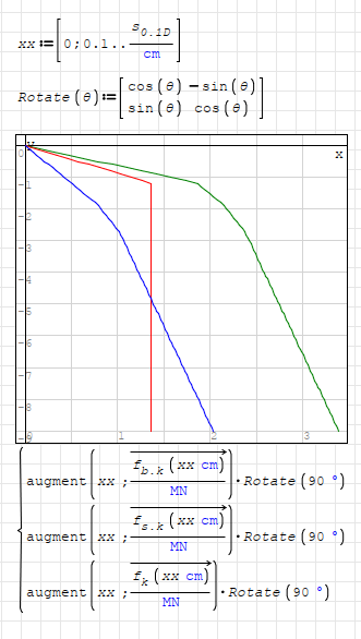

You can also use a rotation matrix.
It works on both 2DPlot an XYplot.
churichuro 13.02.2023 16:11:00
#14 Опубликовано: 13.02.2023 10:41:33
Rotate XY.sm (486,01 КиБ) скачан 1179 раз(а).
