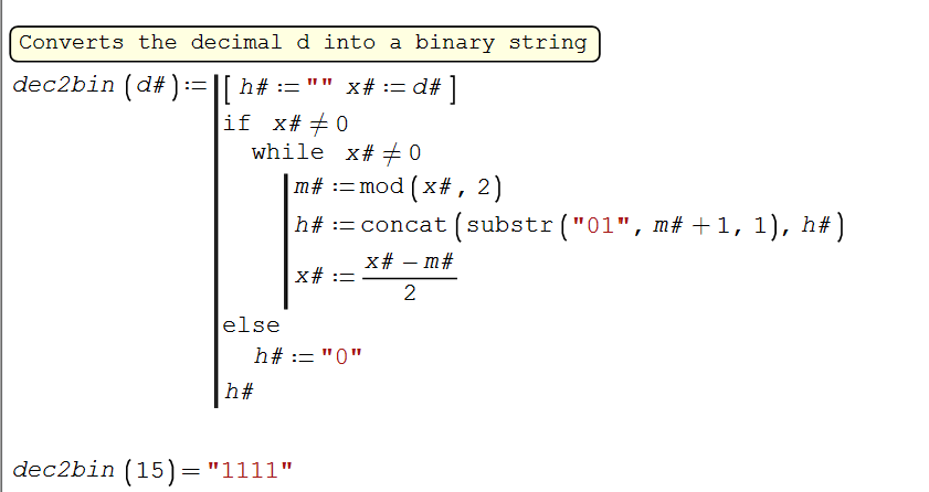

Epic dredge sorry. Functional, with all credit to @Razonar (source/author).
20221227 Dec2bin.sm (4,5 КиБ) скачан 1617 раз(а).

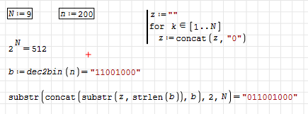

Modification of Razonar's dec2bin() should work well.
dec2bin(p,q) where p is the bit-field length and q is the decimal number to be converted.
Check the converted string's length and then pad the front with zeros to suit.

This may be better achieved via dec2bin() with a constant 9-bit length output so that the 2^n check work consistently (ie string position tests).
Hi. Something like this?
bin_counter.sm (9,7 КиБ) скачан 1538 раз(а).
Cripes Alvaro. Good to see your 'calibrated-crystal-ball' and 'mind-reading skills' are as good as your awesome maths/coding skills!

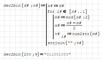

Maybe this can be useful.
dec2bin.sm (3,8 КиБ) скачан 1518 раз(а).
Mark R Harris 29.12.2022 21:03:00
Perfect! Thank you overlord

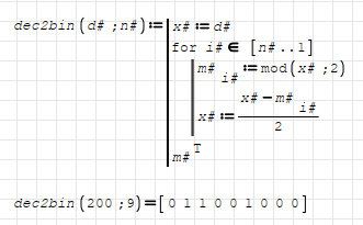

I spoke too soon! Bit-testing don't work so well on a string.
A much better idea is a column vector with each of the 9 (ie n#) elements being either a one or a zero.
#18 Опубликовано: 30.12.2022 05:09:06
This was what I coded first, after that I made it to string.
Here is what you have asked for.
dec2bin.sm (6,09 КиБ) скачан 1505 раз(а).
Mark R Harris 30.12.2022 06:38:00
Maybe, that's what you are looking for ?
Maths Convert num2str EXTENDED.sm (6,72 КиБ) скачан 1565 раз(а).
