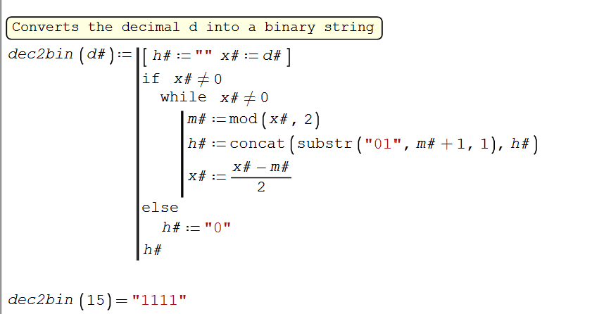

Epic dredge sorry. Functional, with all credit to @Razonar (source/author).
20221227 Dec2bin.sm (4.5 KiB) downloaded 1617 time(s).

Thanks, nice source code.
algo(col) was designed to recover matrix col(s) string(s) to values.
Cheers ... Jean.
Maths Convert-dec2bin.sm (18.88 KiB) downloaded 1521 time(s).

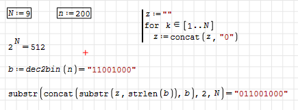

#12 Posted: 12/29/2022 3:39:13 PM
This may be better achieved via dec2bin() with a constant 9-bit length output so that the 2^n check work consistently (ie string position tests).
Hi. Something like this?
bin_counter.sm (9.7 KiB) downloaded 1538 time(s).

Modification of Razonar's dec2bin() should work well.
dec2bin(p,q) where p is the bit-field length and q is the decimal number to be converted.
Check the converted string's length and then pad the front with zeros to suit.

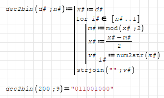

#15 Posted: 12/29/2022 8:46:04 PM
598 likes in 1,380 posts.
Maybe this can be useful.
dec2bin.sm (3.8 KiB) downloaded 1518 time(s).
Mark R Harris 12/29/2022 9:03:00 PM
#16 Posted: 12/29/2022 9:04:15 PM
Mark R Harris
Mark R Harris
4 likes in 90 posts.
Perfect! Thank you overlord

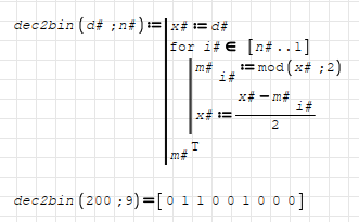

I spoke too soon! Bit-testing don't work so well on a string.
A much better idea is a column vector with each of the 9 (ie n#) elements being either a one or a zero.
#18 Posted: 12/30/2022 5:09:06 AM
This was what I coded first, after that I made it to string.
Here is what you have asked for.
dec2bin.sm (6.09 KiB) downloaded 1507 time(s).
Mark R Harris 12/30/2022 6:38:00 AM
#19 Posted: 12/30/2022 6:39:01 AM
Mark R Harris
Mark R Harris
Thank you so much overlord, that is both elegant and perfect!
#20 Posted: 12/30/2022 11:05:26 AM
Maybe, that's what you are looking for ?
Maths Convert num2str EXTENDED.sm (6.72 KiB) downloaded 1565 time(s).
