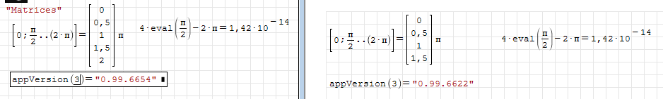

The behaviour of loops with second value seems to have improved. Is this generally fixed or just by chance?

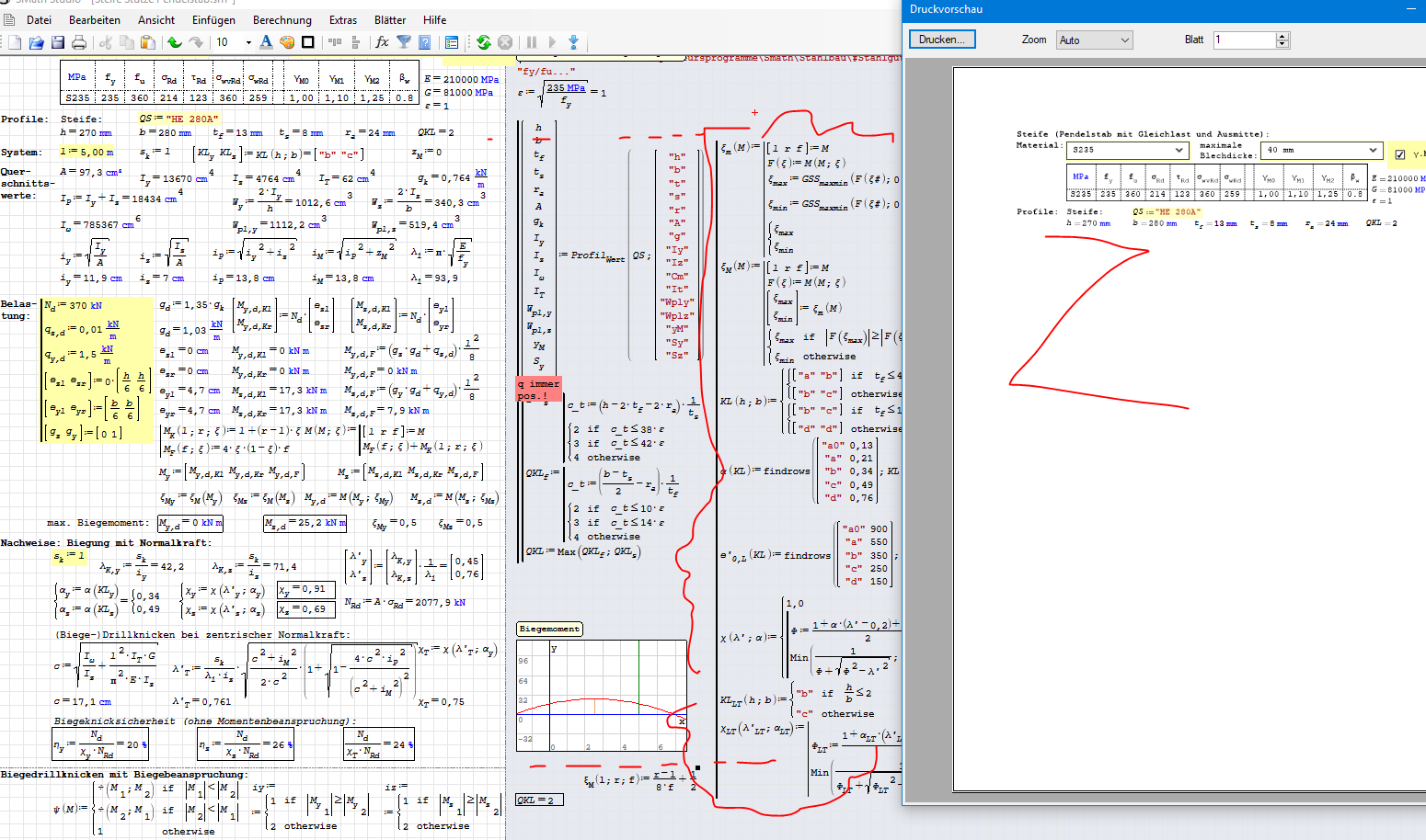

Discovered following behaviour concerning pagebrakes with very long blocks:
(scroll to right if necessary)
The red marked block is so long, that it reaches the top of following page.
As you can see in the preview window, the sheet content is not printed.
Page 2 starts after the page brake with "Biegedrillknicken" when "Printing Bounds" is used.
While using "Pages view", the first printed page looks the same (mostly white) but the second page starts with the skipped content "System l=5,00m..."
Setting the font size only of the large block to something smaller so the bottom of it doesn't reach the page brake solves this issue.

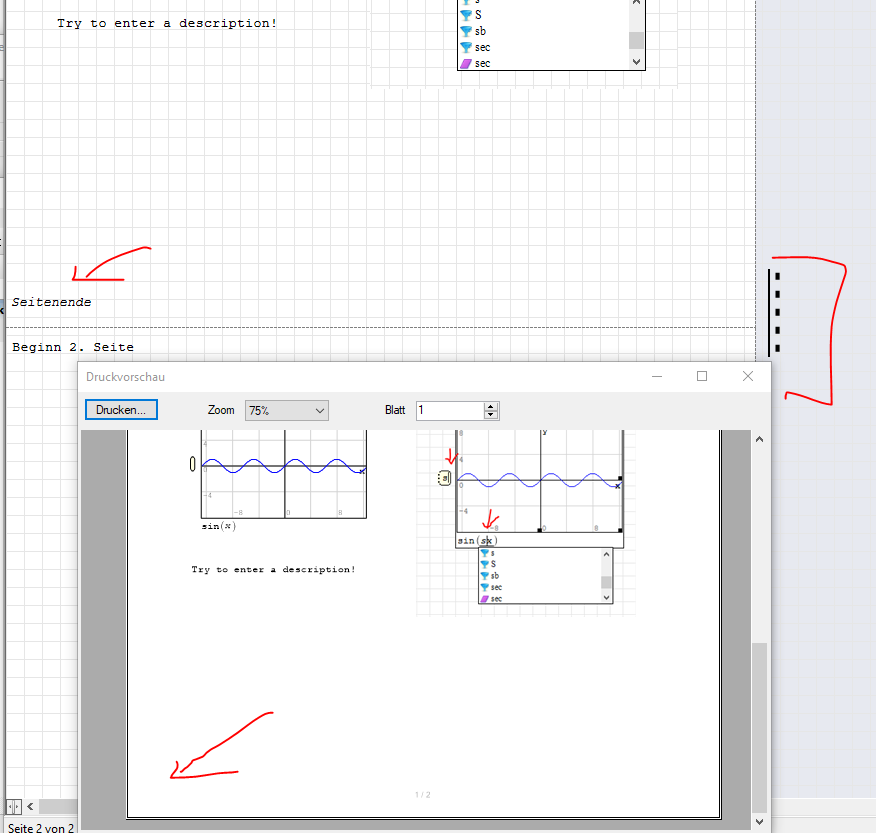

Found another issue, while editing the description of a 2D plot:
When you put the cursor in the description and edit the text, a matching variable in the input data is edited simultaneously.
Screenshot: description is edited -> a second cursor appears in input data

Discovered following behaviour concerning page brakes with very long blocks:
Maybe the problem is the construction ?
Document would surely help volunteers.
Not clear w/o the document.
Here you are:
Pagebrake.sm (70,7 КиБ) скачан 1880 раз(а).

Here you are:
sin(x0 something => no problem Smath 6179
We are here in the "RC2: 0.99.6654"-thread.
So I thought it would be clearly that I refer to 0.99.6654.
Take a look at the video (screen capture) if you don't believe what I am writing.
SMath Studio - [Pagebrake.sm] 27.03.2018 15_58_31.mp4 (2,84 МиБ) скачан 633 раз(а).
Here you are:
The long page brakes are not in the attachment !
Sure they are (I uploaded a simplified example):
Your screen shot is explicit enough, but the document would help
more collab to check that particular issue or similar problem.
Nobody reported this bug, if it is an Smath bug.

Found another issue, while editing the description of a 2D plot: ...
The document is linked in post #7. And the screen capture in post #9.

Can repeat both bugs with the provided file on 6654. Oddly enough I was able to enter a description sometimes without effecting the data field if I first clicked within the data field, then immediately clicked the description field. This only worked occasionally and seemed dependent on where I clicked within the data field.

Quick tip to get rid of "sometimes without effecting the data field"
1. in the description, type few letters not common to data field
2. once finished the description, zap the fake letters.

Here you are:
Thank you! Both issues are reproduced and will be fixed asap.
Was not my goal. Looks like some refactoring might helped.
