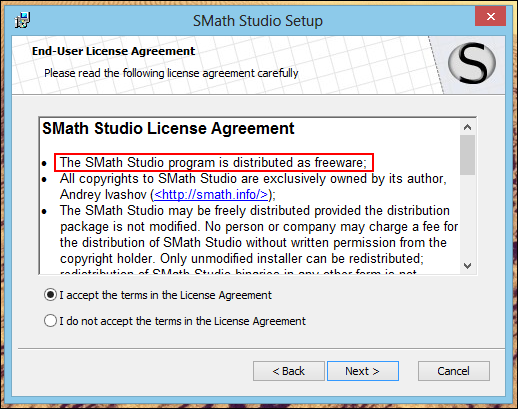

    Yes, That is exactly why I wonder why you have not for commercial use in the new exe plugin.

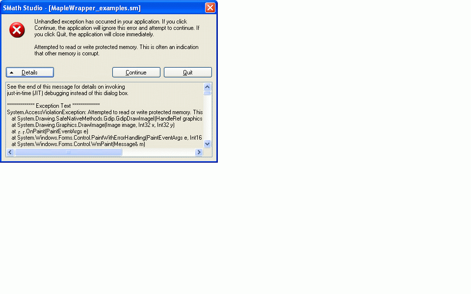

    I got this error when I opened a second Smath
    [albumimg]91[/albumimg]
    It seems that it only happen to my another PC which has been just reinstalled.
    #16 Опубликовано: 01.05.2013 04:18:55
    1222 сообщений из 2150 понравились пользователям.
    Have you added the MapleWrapper Plugin yourself? It is not part of the distribution due to license issues with the maple dos exe. Also, it is not localization-proof (cannot handle non-komma settings as argument delimiter).
    EDIT: Also, I guess that it is not safe to open a second SMath with the MapleWrapper plugin in use. The plugin communicates with maple via file I/O, where different instances of SMath might interfere.
    The maple works on this machine without this error, I think it might be the problem with my windows patches, I will try it later tonigh and see wether I can get it back to work.
    Another issue is the ClosedXML which come with the Data export pulgin doesn't work any more.
