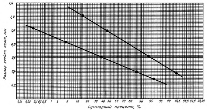

How can I get a function from this plot?
#2 Опубликовано: 06.06.2023 08:59:59
How can I get a function from this plot ?
1. Probably from the expensive digitizer suggested by Richard [Mathsoft Collaboratory]
2. Piecewise from Tracer.
3. Try Mathsoft digitizer.
4. Smath difficult
At this point from the collected data set, fit a model function.
Cheers ... Jean.

#4 Опубликовано: 06.06.2023 10:15:02
⚜ Kenny Lemens, P.E. ᵂᴵ
Greetings,
How can I get a function from this plot? 🖼
That is a straight line on a semi-log graph; you can reference this handout: https://inside.mines.edu/~epoeter/_GW/LAB/EquationsOfStraightLinesOnDifferentTypesGraphPaper.pdf
Per this handout, your equation should be
y = b + m*log(x)
where:
  • m = difference in y over one log cycle of x
  • b = y value corresponding to x=1
May this be of Good Help;

#5 Опубликовано: 06.06.2023 12:44:34
Hi. You can try this post Approximation of a functional curve in a digital image or this other one: Embedding images into a plot
Вячеслав Мезенцев 06.06.2023 14:16:00, Valery Ochkov 06.06.2023 13:45:00

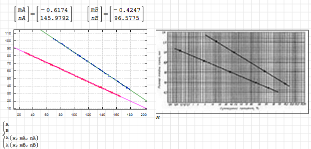

#6 Опубликовано: 06.06.2023 14:19:52
Hello Valery,
some Smath digitizing utilities
Cheers, Jean.
Digitize Tracer 15.sm (28,83 КиБ) скачан 1181 раз(а).
Digitize OVNI Copy.sm (69,15 КиБ) скачан 1186 раз(а).
Digitize Contour Isocurve Himmelblau Copy.sm (106,67 КиБ) скачан 1236 раз(а).
Digitize Curve.sm (295,86 КиБ) скачан 1176 раз(а).
Digitize Contour.sm (829,05 КиБ) скачан 1243 раз(а).
Digitize Clean_Strip_Smooth.sm (1,76 МиБ) скачан 1265 раз(а).
#7 Опубликовано: 06.06.2023 15:29:30
... this Himmelblau has resident Gray matrix.
Digitize Contour Isocurve Himmelblau Copy.sm (107,19 КиБ) скачан 1224 раз(а).
Valery Ochkov 07.06.2023 01:02:00
#8 Опубликовано: 06.06.2023 17:11:16
Hi. Hope this helps.
Modeling a functional curve in a digital image.pdf (860,39 КиБ) скачан 754 раз(а).
Modeling a functional curve in a digital image.sm (1 МиБ) скачан 1303 раз(а).
