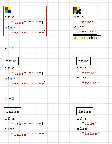

The file is great but when I play with the sliders I every so often get a crash... Using plugin version 1.0.5382.30912 and current standalone Smath.
Confirmed. The post relates to this file
![2014-09-26 09_23_47-SMath Studio Desktop - [Page1_].png](/ru-RU/files/Download/uPNsXD/2014-09-26-09_23_47-SMath-Studio-Desktop---[Page1_].png)
